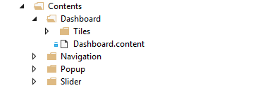

Dashboard
The Contents/Dashboard folder contains all the contents required for the dynamic dashboard in the Plastic Application HMI project.

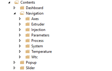

Navigation
The folder Contents/Navigation contains all contents categorized in folders that can be found in the navigation of the Plastic Application HMI project (axes, extruder, injection, parameter, process, system, temperature and WTC). This corresponds to the structure of the Contents/Slider folder in order to make it easier to assign the contents it contains.

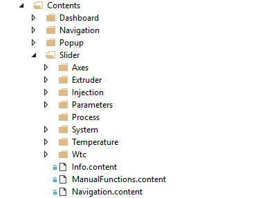

Slider
The Contents/Slider folder contains all contents categorized in folders that are used in the slider area of the Plastic Application HMI project (axes, extruder, injection, parameters, process, system, temperature, WTC, info, manual functions and navigation). This corresponds to the structure of the Contents/ Navigation folder in order to make it easier to identify the contents it contains.
