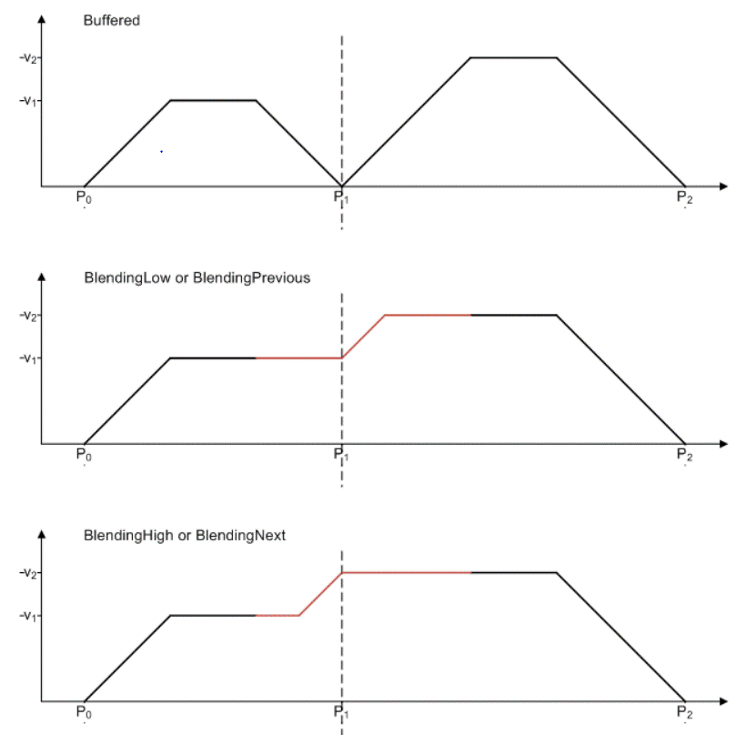

Further data are required in order to utilize blending according to PLC Open. See also FAQ #20.

FAQ #20: How do I prepare an axis for blending based on PLC Open?
In Hydraulik.lib it is possible to command up to 12 buffered movements. For this purpose, a command buffer of type ST_TcPlcCmdCmdBuffer_BkPlcMc must be passed to the MC_AxUtiStandardInit_BkPlcMc function block for updating the axis reference and a function block MC_AxRtCmdBufferExecute_BkPlcMc must be called cyclically.
If Move function blocks such as MC_MoveAbsolute_BkPlcMc, MC_MoveRelative_BkPlcMc or MC_MoveVelocity_BkPlcMc are now activated, they enter their data in the command buffer.
In buffered mode make sure that the Move function blocks and the MC_AxRuntime_BkPlcMc function block of the axis run in a PLC task.
Transition between a slow and a fast section.
Transition between a fast and a slow section.
