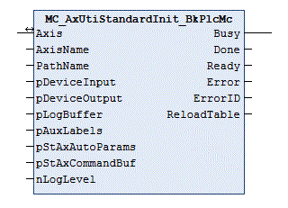

MC_AxUtiStandardInit_BkPlcMc (from V3.0)
The function block handles the initialization and monitoring of axis components.

With each call the function block examines the transferred axis interface and the transferred pointers. If a change is detected, the function block indicates in the transferred Axis_Ref_BkPlcMc structure that the axis has to be reinitialized. The MC_AxParamLoad_BkPlcMc function block used by the function block will now automatically load the axis parameters from the file. If pAuxLabels is supplied, an MC_AxParamAuxLabelsLoad_BkPlcMc function block is then used to load the label texts for the customer-specific axis parameters.
