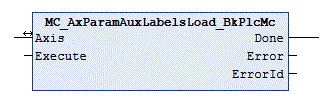

MC_AxParamAuxLabelsLoad_BkPlcMc (from V3.0)
The function block loads the label texts for the customer-specific axis parameters from a file. These texts can be generated with a simple text editor such as Microsoft Notepad.

Inputs
Execute: BOOL;
Name | Type | Description |
Execute | BOOL | The loading process is initiated by a rising edge at this input. |
Inputs/outputs
VAR_INOUT
Axis: Axis_Ref_BkPlcMc;
Axis | Axis_Ref_BkPlcMc | Here, the address of a variable of type Axis_Ref_BkPlcMc should be transferred. |
Outputs
Done: BOOL;
Error: BOOL;
ErrorID: UDINT;
Done | BOOL | Successful loading of the parameters is indicated here. |
