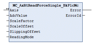

MC_AxRtReadForceSingle_BkPlcMc (from V3.0)
The function block handles determination of the actual force of the axis from the input data of an analog input terminal. The actual pressure on the A- or B-sides is converted to the force acting on the load, taking into account the area and the sliding friction.

Inputs
AdcValueA: INT:=0;
AdcValueB: INT:=0;
ScaleFactorA: LREAL:=0.0;
ScaleOffsetA: LREAL:=0.0;
ScaleFactorB: LREAL:=0.0;
ScaleOffsetB: LREAL:=0.0;
SlippingOffset: LREAL:=0.0;
ReadingMode: E_TcMcPressureReadingMode:=iTcHydPressureReadingDefault;
