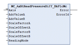

MC_AxRtReadPressureDiff_BkPlcMc (from V3.0)
The function block handles determination of the actual pressure of the axis from the input data of two analog input terminals.
![]() | If only one input signal is available, a function block of type MC_AxRtReadPressureSingle_BkPlcMc should be used. If the force is to be determined, instead of the pressure, a function block of type MC_AxRtReadForceDiff_BkPlcMc should be used. |
Inputs
AdcValueA: INT:=0;
AdcValueB: INT:=0;
ScaleFactorA: LREAL:=0.0;
ScaleOffsetA: LREAL:=0.0;
ScaleFactorB: LREAL:=0.0;
ScaleOffsetB: LREAL:=0.0;
ReadingMode: E_TcMcPressureReadingMode:=iTcHydPressureReadingDefault;
Name | Type | Description |
AdcValueA | INT | These parameters are used to transfer the input data of the analog terminals. |
AdcValueB | INT | |
ScaleFactorA | LREAL | [bar/ADC_INC] This value represents the weighting. It determines which pressure increase corresponds to a stage of the AD converter. |
ScaleOffsetA | LREAL | [bar] This offset is used to correct the zero point of the pressure scale. |
ScaleFactorB | LREAL | [bar/ADC_INC] This value represents the weighting. It determines which pressure increase corresponds to a stage of the AD converter. |
ScaleOffsetB | LREAL | [bar] This offset is used to correct the zero point of the pressure scale. |
ReadingMode | E_TcMcPressureReadingMode | This parameter is used to specify where the result of the evaluation is to be stored. |
Inputs/outputs
VAR_INOUT
Axis: Axis_Ref_BkPlcMc;
Axis | Axis_Ref_BkPlcMc | Here, the address of a variable of type Axis_Ref_BkPlcMc should be transferred. |
Outputs
Error: BOOL;
ErrorID: UDINT;
Behaviour of the function block:
The function block investigates the axis interface that has been passed to it every time it is called. During this process, a problem may be detected and reported:
- If the pointer pStAxRtData in Axis_Ref_BkPlcMc is not initialized, the function block reacts with an Error and ErrorID:=dwTcHydErrCdPtrMcPlc. In this case, the axis cannot be placed into a fault state.
If these checks could be performed without problem, the actual pressure of the axis is determined by evaluating the variables AdcValueA and AdcValueB. The result is entered in ST_TcHydAxRtData.fActPressure.
The parameters assigned to an axis can be saved in ST_TcHydAxParam.fCustomerData[...], for example. This ensures that the data are loaded, saved and backed up together with the standard parameters of the axis and are also exported and imported, as required.
