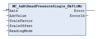

MC_AxRtReadPressureSingle_BkPlcMc (from V3.0)
The function block handles determination of the actual pressure of the axis from the input data of an analog input terminal.
![]() | If separate input signals are available for the A and B sides, a function block of type MC_AxRtReadPressureDiff_BkPlcMc should be used. |
Inputs
AdcValue: INT:=0;
ScaleFactor: LREAL:=0.0;
ScaleOffset: LREAL:=0.0;
ReadingMode: E_TcMcPressureReadingMode:=iTcHydPressureReadingDefault;
Name | Type | Description |
AdcValue | INT | These parameters are used to transfer the input data of the analog terminal. |
ScaleFactor | LREAL | [bar/ADC_INC] This value represents the weighting. It determines which pressure increase corresponds to a stage of the AD converter. |
ScaleOffset | LREAL | [bar] This offset is used to correct the zero point of the pressure scale. |
ReadingMode | E_TcMcPressureReadingMode | The actual value to be determined can be specified here. Axis_Ref_BkPlcMc.ST_TcHydAxRtData.fActPressure is selected as default value. |

Outputs
Error: BOOL;
ErrorID: UDINT;
Behaviour of the function block:
The function block investigates the axis interface that has been passed to it every time it is called. During this process, a problem may be detected and reported:
- If the pointer pStAxRtData in Axis_Ref_BkPlcMc is not initialised, the function block reacts with an Error and ErrorID:=dwTcHydErrCdPtrMcPlc. In this case, the axis cannot be placed into a fault state.
If these checks could be performed without problem, the actual pressure of the axis is determined by evaluating the variables AdcValue. The result is entered in ST_TcHydAxRtData.fActPressure.
