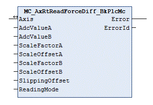

MC_AxRtReadForceDiff_BkPlcMc (from V3.0)
The function block handles determination of the actual force of the axis from the input data of two analog input terminals. The actual pressure on the A- and B-sides is converted to the force acting on the load, taking into account the areas and the sliding friction.
If only one input signal is available, a function block of type MC_AxRtReadForceSingle_BkPlcMc should be used. If the actual pressure is to be determined, a function block of type MC_AxRtReadPressureDiff_BkPlcMc should be used.

Inputs/outputs
VAR_INOUT
Axis: Axis_Ref_BkPlcMc;
Name | Type | Description |
Axis | Axis_Ref_BkPlcMc | Here, the address of a variable of type Axis_Ref_BkPlcMc should be transferred. |
