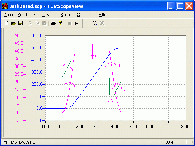

iTcMc_ProfileJerkBased
A profile is generated with a time-controlled acceleration phase (with optional jerk limitation), a displacement-controlled braking ramp based on the square root generator principle, and a target approach with jerk limitation.
The arrows on the profile of the control value suggest how the shape of the curve can be affected through the parameters of the move order or of the axis. To begin with, a time-controlled ramp function "1" is used to accelerate to the required travel velocity "2". The optional jerk limitation "6" can take effect. The travel speed is maintained until a point is reached that was recalculated at the start. At this point a displacement-controlled braking ramp "3" is applied, until the distance to the target has reduced to the residual distance. The deceleration "4" is reduced with limited jerk "5" towards the target. The axis is then switched to its idle behavior.
Parameters active in the travel profile
Start ramp "1": The smallest of the following values is the effective one: fMaxAcc and fAcc in Axis.ST_TcHydAxParam, Acceleration of the function block used to start the axis (for example: MC_MoveAbsolute_BkPlcMc).
Travel phase "2": The smallest of the following values is the effective one: fRefVelo and fMaxVelo in Axis.ST_TcHydAxParam, Velocity of the function block used to start the axis (for example: MC_MoveAbsolute_BkPlcMc).
Braking ramp "3", "4": The smallest of the following values is the effective one: fMaxDec and fDec in Axis.ST_TcHydAxParam, Deceleration of the function block used to start the axis (for example: MC_MoveAbsolute_BkPlcMc).
Transfer to target "5": fMaxJerk in Axis.ST_TcHydAxParam and fJerk of the function block used on axis start take effect (example: MC_MoveAbsolute_BkPlcMc) and fBrakeDistance and/or fBrakeDeadTime in Axis.ST_TcHydAxParam.

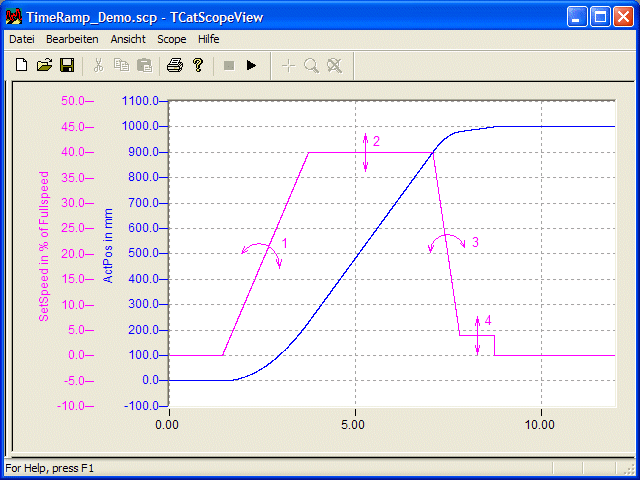

iTcMc_ProfileTimeRamp
A profile is generated with a time-controlled acceleration phase, a time-controlled braking phase and a target approach with creep speed.
The arrows on the profile of the control value suggest how the shape of the curve can be affected through the parameters of the move order or of the axis. To begin with, a time-controlled ramp function "1" is used to accelerate to the required travel velocity "2". This control value is maintained until the direction-specific target window cam is detected. From here, a time-controlled ramp "3" is applied to decelerate from the set motion value to the set creep value "5". This control value is maintained until the direction-specific target cam is detected. The axis is then switched to its idle behavior.
Start ramp "1": fStartRamp has an effect in Axis.ST_TcHydAxParam.
Braking ramp "3": fStopRamp has an effect in Axis.ST_TcHydAxParam.
Creep phase "4": fCreepSpeed has an effect in Axis.ST_TcHydAxParam.

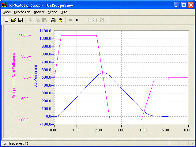

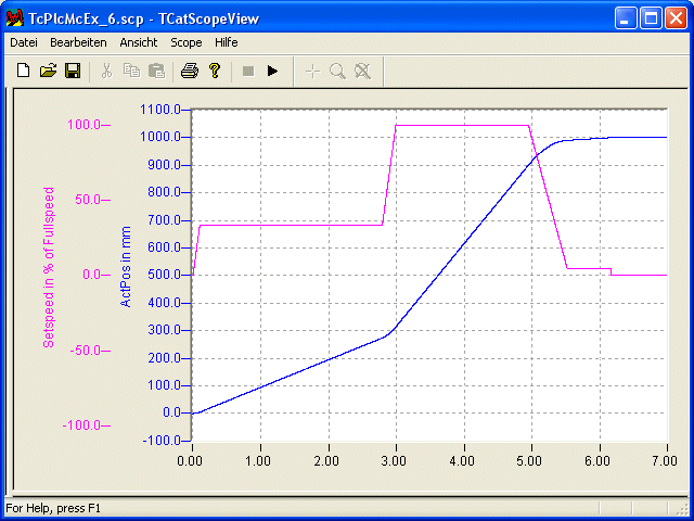

Behavior of the function block on restart during a motion
If a further start command is issued during an active movement, a distinction has to be made between two cases.
This profile is created on restart in the same direction with a different velocity (higher in this case).
This profile is created on restart in the opposite direction, in this case with the same velocity.
