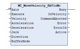

MC_MoveVelocity_BkPlcMc (from V3.0)
This function block starts and monitors the movement of an axis.
Inputs
Execute: BOOL;
Velocity: LREAL;
Acceleration: LREAL;
Deceleration: LREAL;
Direction: MC_Direction_BkPlcMc;
BufferMode: MC_BufferMode_BkPlcMc:=Aborting_BkPlcMc; (ab/from V3.0.8)
Name | Type | Description |
Execute | BOOL | The movement is initiated by a rising edge at this input. |
Velocity | LREAL | [mm/s] The required motion velocity in actual value units of the axis per second. |
Acceleration | LREAL | [mm/s2] The required acceleration in actual value units of the axis per square second. |
Deceleration | LREAL | [mm/s2] The required deceleration in actual value units of the axis per square second. |
Direction | MC_Direction_BkPlcMc | A direction specification coded according to MC_Direction_BkPlcMc. |
BufferMode | MC_Direction_BkPlcMc | reserved. This input is provided in preparation for a future build. It should currently either not be assigned or assigned the constant Aborting_BkPlcMc. (from V3.0.8) |
Inputs/outputs
VAR_INOUT
Axis: Axis_Ref_BkPlcMc;
Axis | Axis_Ref_BkPlcMc | Here, the address of a variable of type Axis_Ref_BkPlcMc should be transferred. |
Outputs
Busy: BOOL;
InVelocity: BOOL;
CommandAborted: BOOL;
Error: BOOL;
ErrorID: UDINT;
Busy | BOOL | Indicates that a command is being processed. |
InVelocity | BOOL | This output becomes TRUE when the axis reaches the required velocity for the first time. |
CommandAborted | BOOL | Abortion of the movement is indicated here. |
On a rising edge at Execute the function block checks the transferred axis interface. A number of problems can be detected and reported during this process:
- Depending on the motion algorithm specified in Axis.pStAxParams^.nProfile the axis may either only be able to begin the movement initiated here when stationary, or may be able to begin from another movement that has not yet been completed. If it is unable at the present time to accept this new order, the system responds with Error and ErrorID:=dwTcHydErrCdNotStartable.
- If the axis is already in an error state, or if it is in the process of carrying out a stop operation, it responds with Error and ErrorID:=dwTcHydErrCdNotReady.
- If Velocity is too small (less than 1% of the reference velocity) the system responds with Error and ErrorID:=dwTcHydErrCdSetVelo.
- If the motion algorithm is already indicating an error code, the system responds with Error and ErrorID:= the motion algorithm's error code.
The movement begins if these checks can be carried out without problems. This is done by selecting a value for the target position depending on Direction and the parameters for the software limit switches. This is done by limiting the parameters Velocity, Acceleration and Deceleration to the maximum permissible values and passing them to the motion algorithm. The axis is now in the McState_Continousmotion state, and the function block begins to monitor the movement.
If the motion algorithm reports an error code while the movement is being executed, the system responds with Error and ErrorID:=the motion algorithm's error code. If completion of the movement is prevented by the activity of another function block, the system responds with CommandAborted. InVelocity is set when the motion algorithm reaches the required velocity.
A falling edge at Execute clears all the pending output signals. If, while the movement is still active, Execute is set to FALSE, execution of the movement that had started continues unaffected. The signals provided at the end of the movement (Error, ErrorID, CommandAborted, InVelocity) are made available for one cycle.
