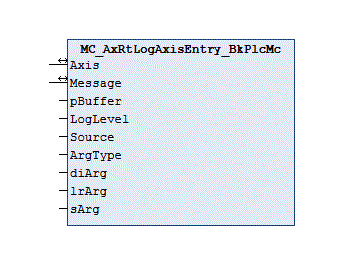

MC_AxRtLogAxisEntry_BkPlcMc (from V3.0)
The function block enters an axis-related message in the LogBuffer of the library. Further information about creating a log buffer can be found under FAQ #10 in the Knowledge Base.
![]() | All axis-related library function blocks use this function block for message outputs. |
Inputs
pBuffer: POINTER TO ST_TcPlcMcLogBuffer;
LogLevel: DWORD:=0;
Source: DWORD:=0;
Message: STRING(255);
ArgType: INT:=0;
diArg: DINT:=0;
lrArg: LREAL:=0;
sArg: STRING(255);
Name | Type | Description |
pBuffer | POINTER | Here the address of a variable of type ST_TcPlcMcLogBuffer is to be transferred. |
LogLevel | DWORD | A coded specification of the message type. A Logger Levels value from the Global Constants should be used. |
Source | DWORD | A coded specification of the message source. A Logger Sources value from the Global Constants should be used. |
Message | STRING | The message text. |
ArgType | INT | The type of the optional argument. |
diArg | DINT | The value of the optional argument, if it is of type DINT. |
lrArg | LREAL | The value of the optional argument, if it is of type LREAL. |
sArg | STRING | The value of the optional argument, if it is of type STRING. |
Inputs/outputs
VAR_INOUT
Axis: POINTER TO Axis_Ref_BkPlcMc;
Axis | POINTER | Here, the address of a variable of type Axis_Ref_BkPlcMc should be transferred |
The only difference between the function block and MC_AxRtLogEntry_BkPlcMc is that the axis name appears before the message.
