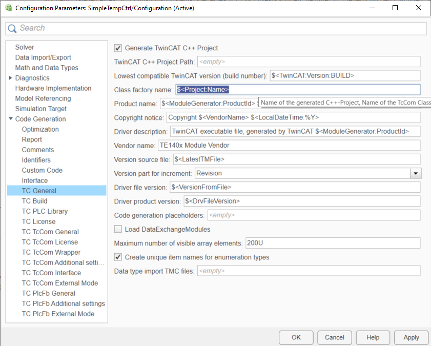

Available placeholders
Placeholders are used in the Target for Simulink® configuration to reduce configuration effort and increase clarity. Placeholders are specified in the configuration with $<PlaceholderName>.
Available placeholders 1:
What are placeholders?
Placeholders can be used to specify the value of a configuration parameter abstractly as a variable. Specific placeholders exist at the level of the target (module generator), the project and the modules (TcCOM and PLC FB). Furthermore, the configuration parameter itself is also a placeholder, so you can reuse it.
Example:
In the above graphic, the driver product version is specified with the placeholder $<DrvFileVersion>. This placeholder points to the driver file version entry, which in turn is occupied by the placeholder $<VersionFromFile>. The placeholder $<VersionFromFile> assumes the version value, where the source of the version value is defined with the version source file parameter.
Why do we need placeholders?
Placeholders allow us to define a parameter value and reuse it in many places in the configuration, or to set them in a chain dependency in relation to each other (see example above).
Overview of available placeholders

$<Project:Name>
Name of the generated C++-Project, Name of the TcCOM classfactory and tmx-file name

VendorName
Vendor name
TE140x Module Vendor
Module vendor name, used as the company name of the generated executables in the repository and the major module group as shown in the TwinCAT XAE module dialog.

DrvFileVersion
Driver file version
$<VersionFromFile>
Executable file version and library version.
DrvProductVersion
Driver product version
$<DrvFileVersion>
