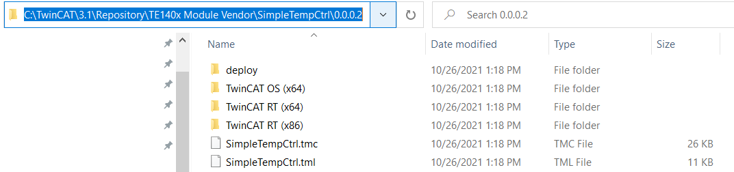

The files of the model SimpleTempCtrl in version 0.0.0.2 from the Vendor TE140x Module Vendor must be located at this position, for example:

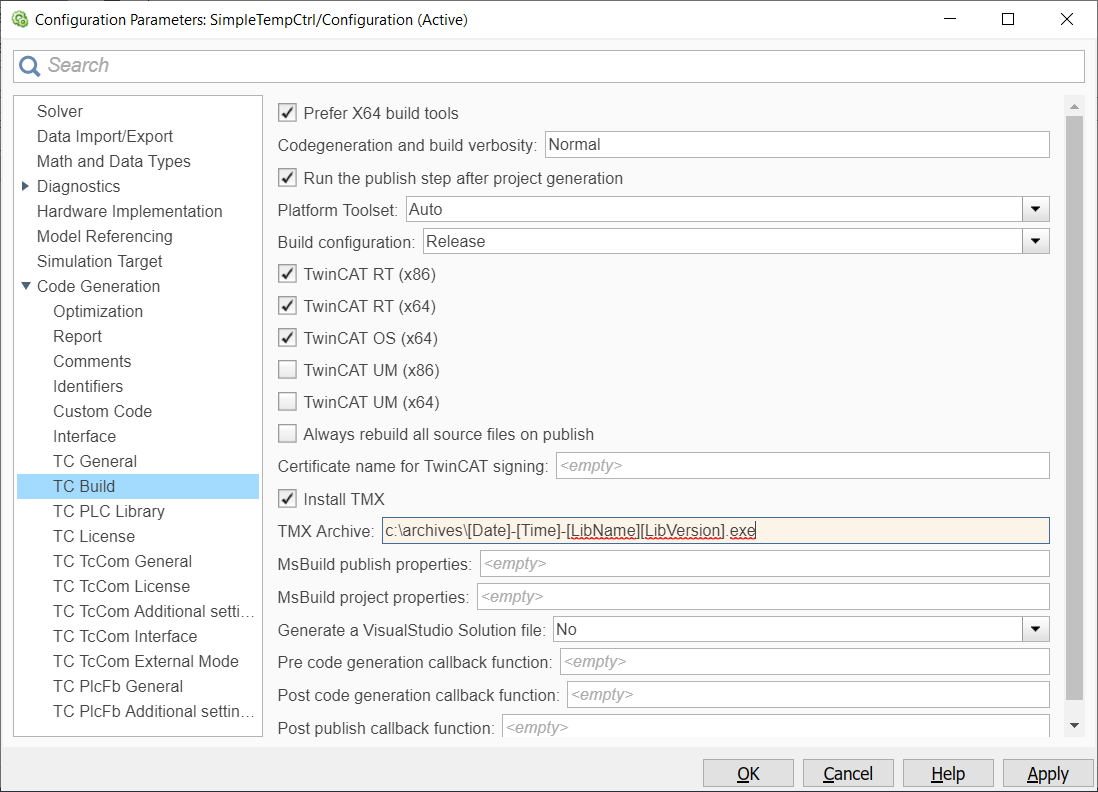

You can specify the path and name of the TMX archive under TC Build to have it created with the next build.
Sharing created TwinCAT objects 3:
You can also use placeholders for the path and name as shown in the sample above. Result of this setting is e.g. a TMX archive 2021-11-04-172921-SimpleTempCtrl0.0.0.3.exe (new build, therefore revision incremented).

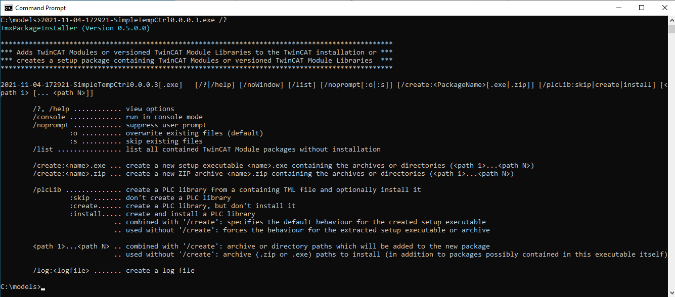

Alternatively, you can also use the Command Prompt. Call the help of the TmxPackageInstaller via:
<tmxarchive>.exe /?
Sharing created TwinCAT objects 4:
For example, to unpack a TMX archive and install the PLC library it contains in the local TwinCAT Engineering, execute the following command in the command line:
<tmxarchive>.exe /plclib:install
