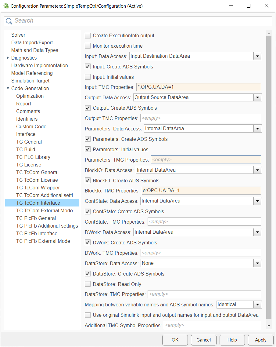

In Simulink® you can freely assign Properties as a string in the Configuration Parameters under TC TcCom Interface. Properties can be defined for the DataArea:
In addition, you can use the Additional TMC Symbol Properties field to assign properties independently of the DataArea.
Symbol Properties and Attribute Pragmas 1:
You can also use the symbol properties in connection with the TC Module Input or Output blocks on the Simulink® block diagram.
The following notation is used for DataArea specific TMC properties:
SymbolName1:PropertyName1=Value1
Sample: FeedbackTemp:OPC.UA.DA=1
If several properties are to be assigned, they must be separated with |:
SymbolName1:PropertyName1=Value1|SymbolName2:PropertyName2=Value2
Sample: HeaterOn:OPC.UA.DA=1|HeaterOn:OPC.UA.DA.Access=3
wildcards can be used from MATLAB® R2020b:
*:PropertyName1=Value1
The * character is used as a wildcard and in this sample assigns the PropertyName1 with Value1 to all symbols in the DataArea. Substrings can also be combined with wildcards. The following sample assigns the specified property to all symbols that begin with Sum.
Sum*:OPC.UA.DA=1

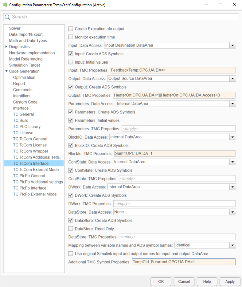

The same structure must be used in the Additional TMC Symbol Properties field. However, the DataArea must be added for addressing.
DataAreaName1.SymbolName1:PropertyName1=Value1
Sample: TempCtrl_B.current:OPC.UA.DA=1

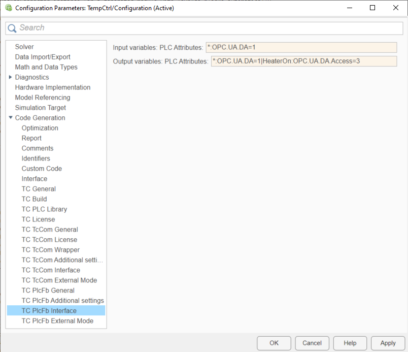

The same procedure as for TcCOM applies to the PLC-FB, but there it is only possible for the inputs and outputs. When using the TcCOM Wrapper FB a TcCOM is referenced, so that you make the configuration according to TMC Properties.
The configuration for the PLC-FB is done under TC PlcFb Interface.

The following example shows how all input variables of the Input DataArea and only the signal e from the BlockIO DataArea are provided with the OPC-UA data access property. The wildcard * is used for the input DataArea.
Symbol Properties and Attribute Pragmas 4:

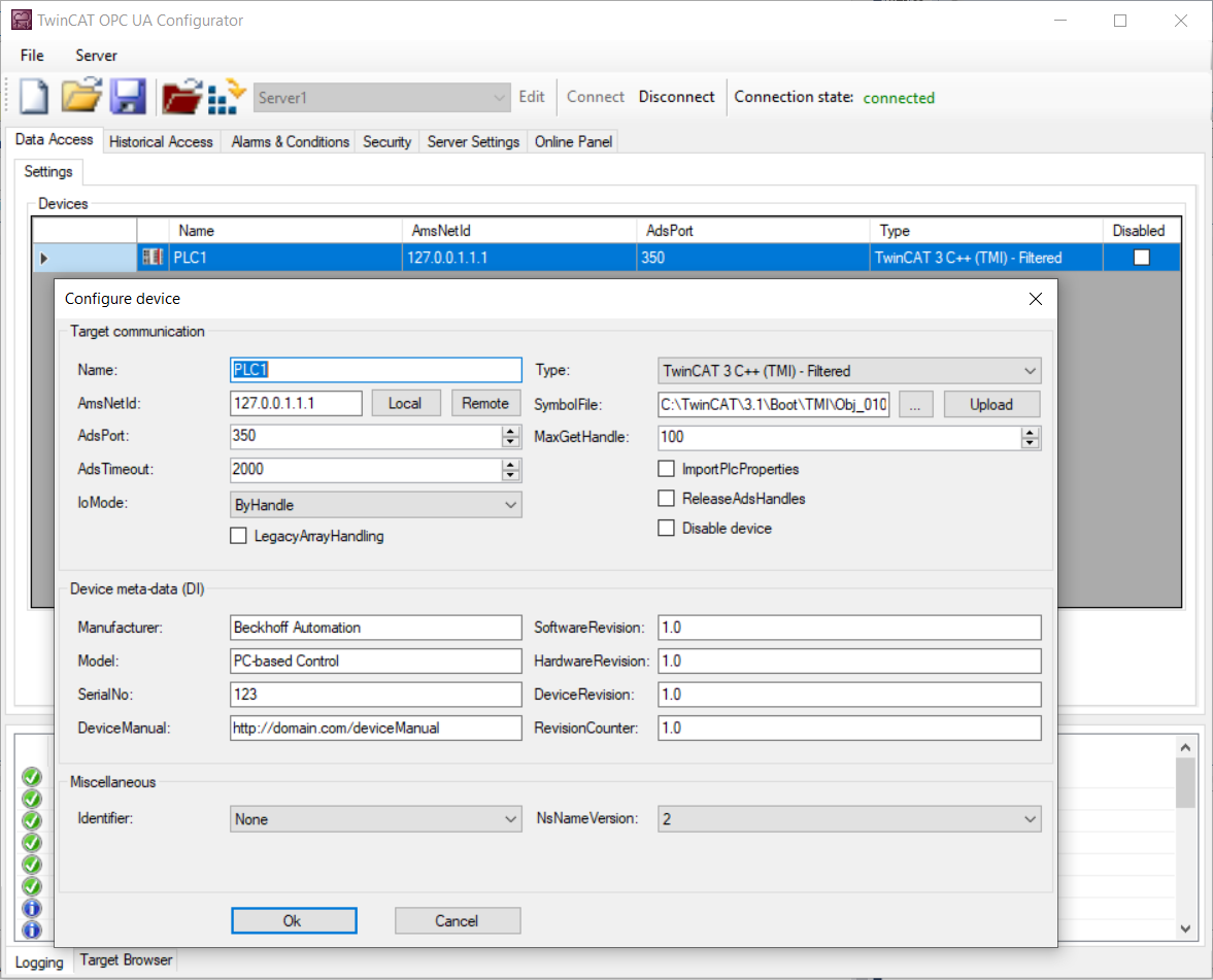

You have to select TwinCAT 3 C++ (TMI) - Filtered on the right side under Type in the OPC-UA configurator, so that only the symbols with the corresponding property are displayed in the server. If you want to see all symbols in the server, simply select TwinCAT 3 C++ (TMI) - All at this point. Then all symbols will be displayed, regardless of the properties. Also select the TMI file of the TcCOM on the TwinCAT Target Device as SymbolFile (Boot\TMI Folder).
Symbol Properties and Attribute Pragmas 5:

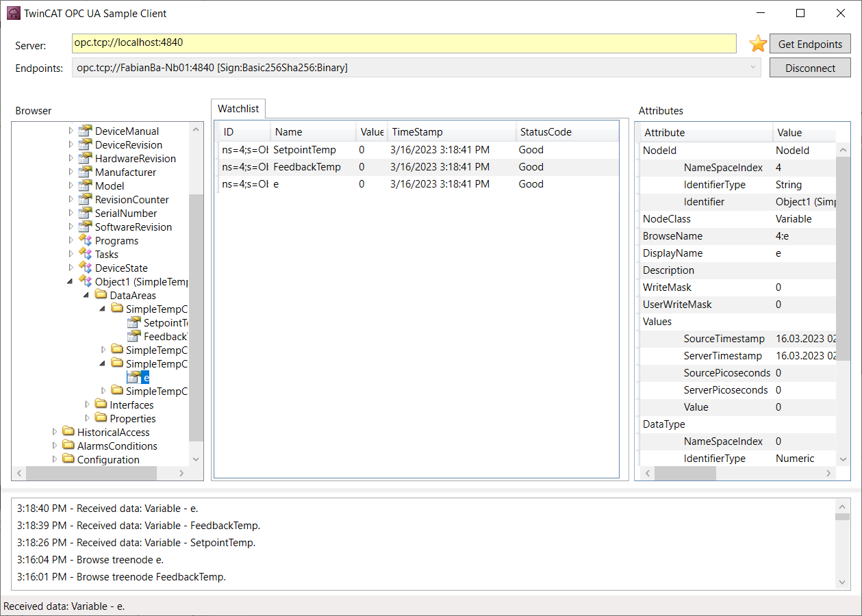

Connect to the OPC-UA Server with a client to inspect the namespace. Here the OPC-UA Sample Client of TwinCAT 3 was used. You can see that only those symbols are displayed in the server that have been explicitly assigned the OPC.UA.DA=1 property.
