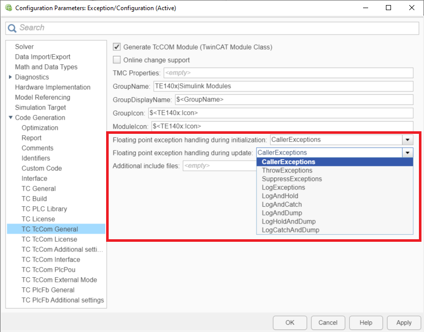

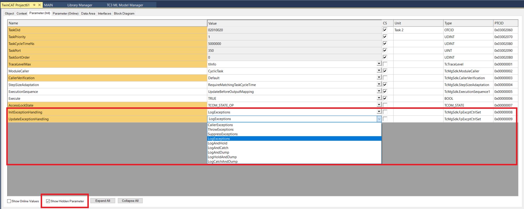

<< Setting for TcCOM >>
You can define the behavior of a TcCOM object when exceptions occur under TC TcCOM General in the Code Generation Settings in Simulink®. The behavior must be defined separately for the initialization phase of the TcCOM and for the runtime phase (update phase).
If you are working with an already compiled TcCOM in TwinCAT, you can also change the settings on the object instance afterwards. To do this, use the Parameters (init) tab and select Show hidden Parameters.

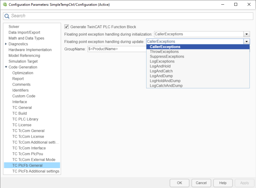

<< Setting for PLC-FB >>
The settings for the PLC-FB (PLC function block FB_<ModelName> in the PLC library) must be made independently of the settings for the TcCOM object at TC PlcFb General. A subsequent adaptation of the exception options when using the function block in TwinCAT is not provided.
Note that the other PLC function block FB_<ModelName>_TcCOM is a wrapper for a TcCOM object and therefore the exception settings from the TcCOM area are valid when it is used.

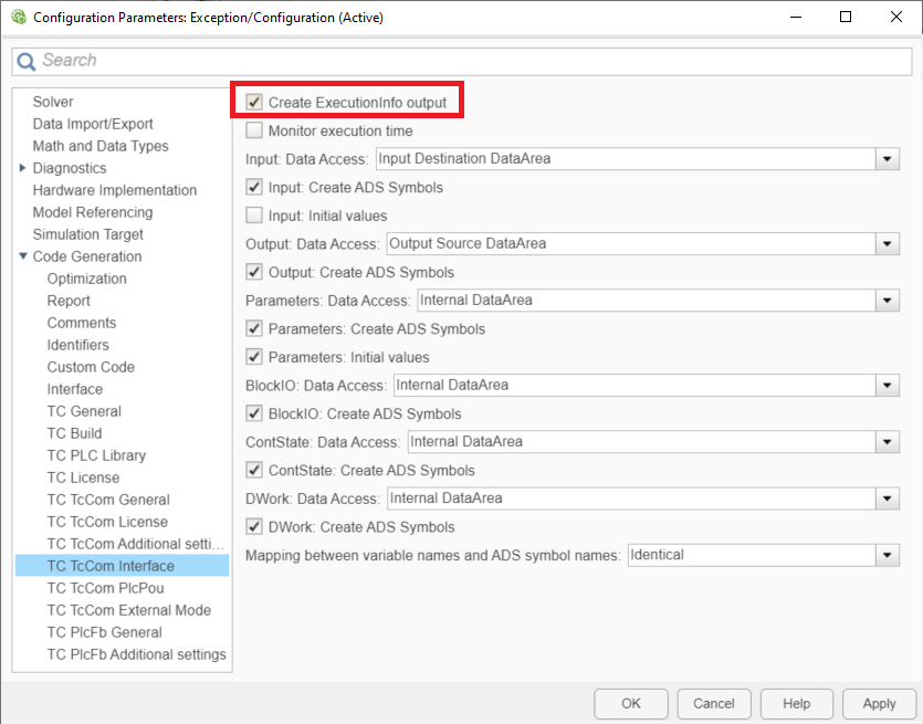

You can activate an additional "ExecutionInfo" output for the TcCOM object via the TC TcCom Interface entry.
The ExecutionInfo output is a structure with the following entries:

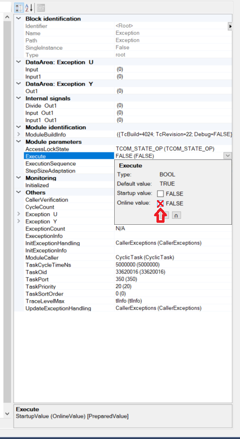

In the event of an exception, execution of the code in the TcCOM object or PLC function block (PLC-FB) concerned is stopped by setting the Execute parameter to FALSE.

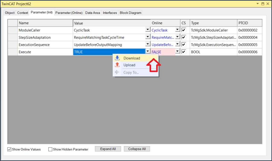

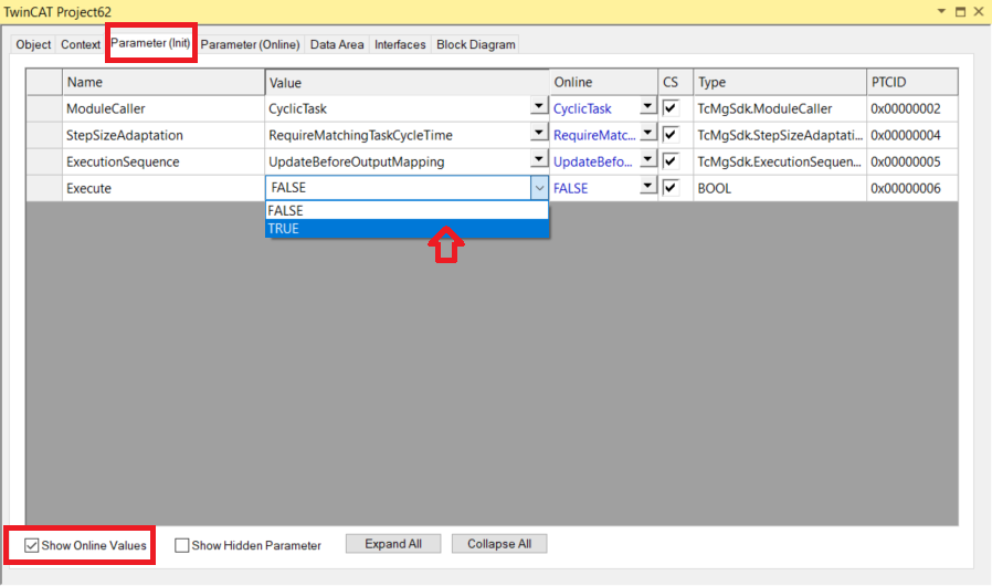

The Execute parameter can be read or written from the XAE and via ADS.
In the XAE, you can display and change the online values of the TcCOM object under Parameters (Init).
In the block diagram the parameter is offered to you under Module parameters.

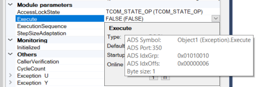

If you move the mouse over the Execute name in the change dialog, you will be shown the ADS address of the parameter, as with all other parameters. This allows you to set the parameter also by ADS.

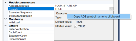

By right-clicking on the name Execute you can also save the ADS symbol information to the clipboard. This also applies to all other parameters.
