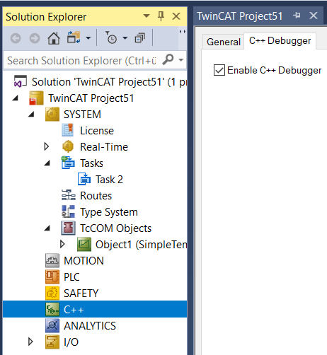

Your TwinCAT application has been activated with the C++ debugger enabled.

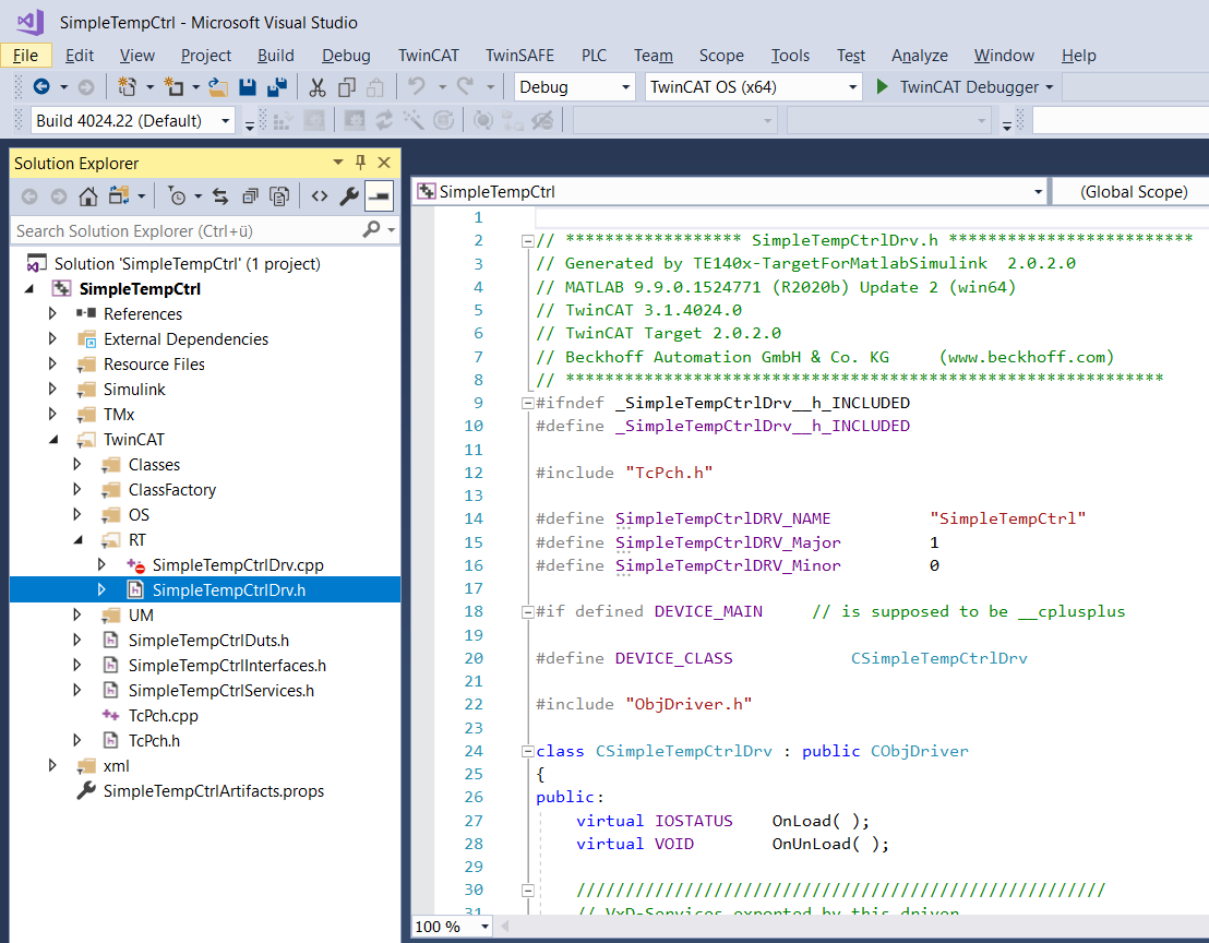

1. Open the C++ project created during code generation that belongs to the module you want to debug.
The project can be found in the folder <SimulinkModelName>_tcgrt, which is created in the current MATLAB® path when you start the code generation process.
2. In this folder, search for the file <SimulinkModelName>.vcxproj.
You can open the <SimulinkModelName>.vcxproj in Visual Studio alone or also add the vcxproj file in your TwinCAT Solution under C++ with “Add existing Item”.

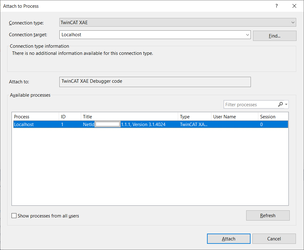

3. Select Debug > Attach to Process in the menu bar, select “TwinCAT XAE” as the Connection type, and the desired target system under Connection target. Then select Attach.

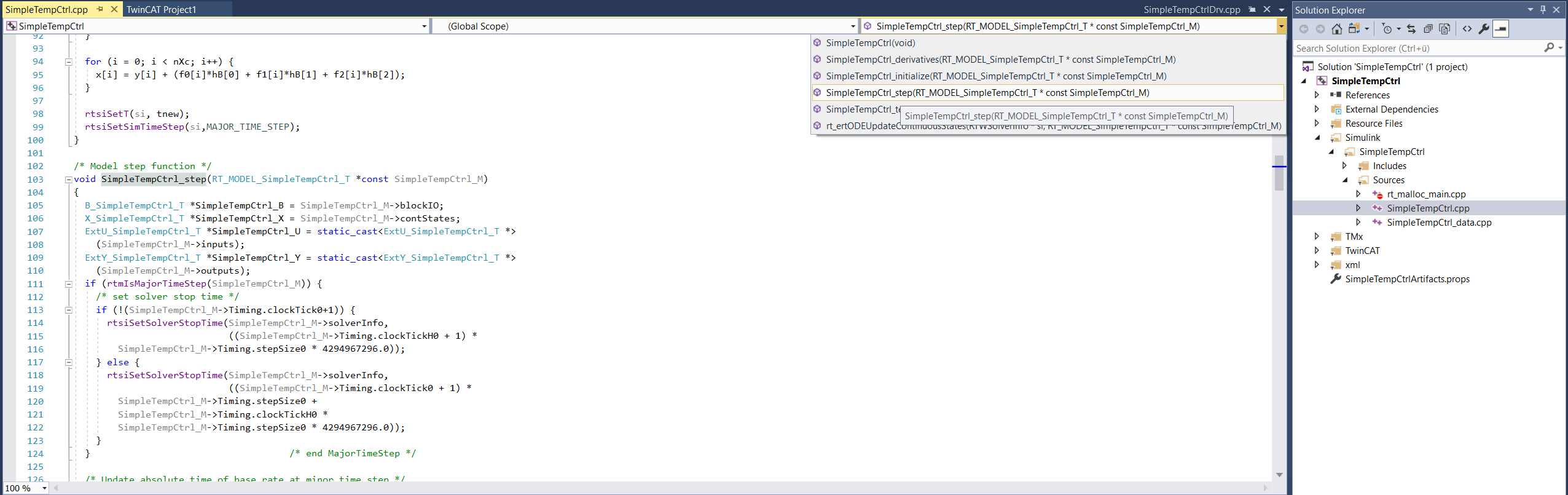

4. Set breakpoints in your C++ code and step through your code as usual. Tip: when executing the code, the step function is used, which you can find in the folder Simulink® > Sources > <SimulinkModelName>.cpp.
