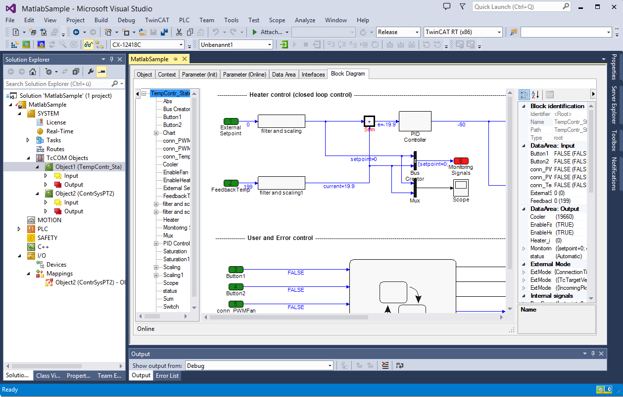

Setting breakpoints in the block diagram
- 1. After attaching the debugger to the TwinCAT runtime, the possible breakpoints are assigned to the blocks in the block diagram and represented as points. Clicking on the desired breakpoint activates it, so that execution of the module instance is stopped next time the associated function block is executed. The color of the point provides information about the current state of the breakpoint:
- Gray: breakpoint inactive
- Red: breakpoint active. The program is stopped next time this function block is executed
- Yellow dot in the middle: breakpoint hit. Program execution is currently stopped at this point
- Blue dot in the middle: breakpoint hit (as yellow), but in a different instance of the module.

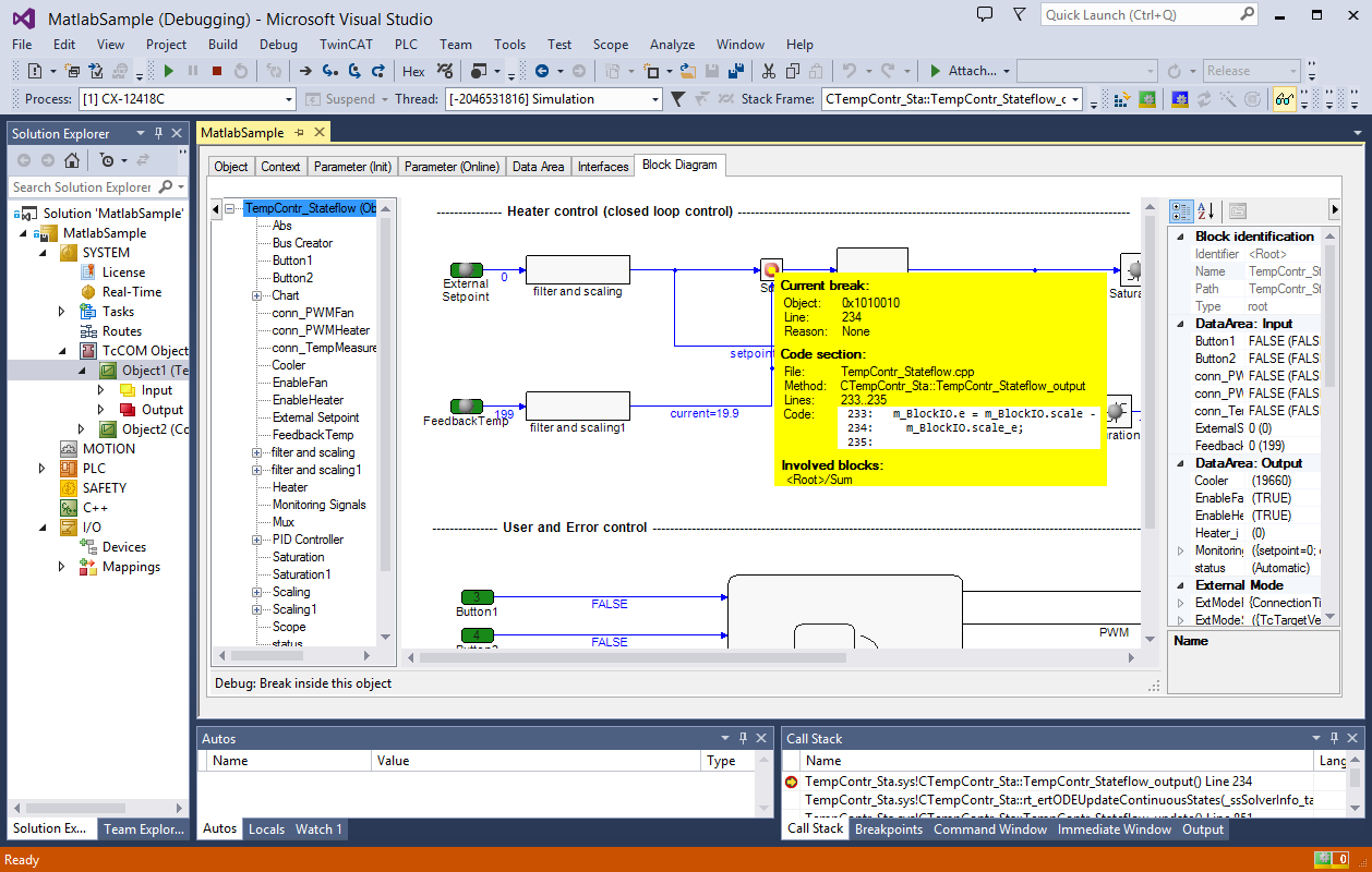

- 2. Additional information, such as the corresponding C++ code section, can be found in the tooltip for the breakpoint:
![]() | Breakpoints are not always assigned to a single function block. In many cases, the functions of several blocks are consolidated in a code section or even a line in the underlying C++ code. This means that several blocks can share the same breakpoint. Therefore, activation of a breakpoint in the block diagram may also result in changes in the point display in other blocks. |

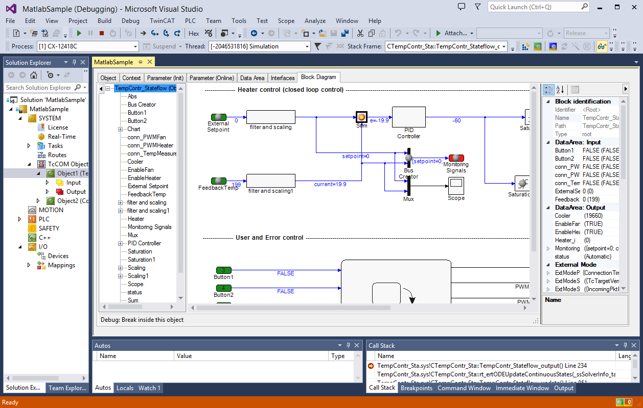

Evaluating exceptions
If exceptions occur during processing of a TcCOM module, such as division by zero, the point at which the exception occurred can be shown in the block diagram. To this end, the TcCOM module must meet the above requirements, and the C++ debugger must be enabled in the TwinCAT project (TwinCAT 3 C++ Enable C++ debugger). After the debugger has been attached, which may be done before the exception has occurred or indeed after, the block that caused the exception is highlighted in the block diagram, provided the line of code responsible for the exception can be allocated to a block. The name of the function block is shown in red, and the function block itself is marked in bold.

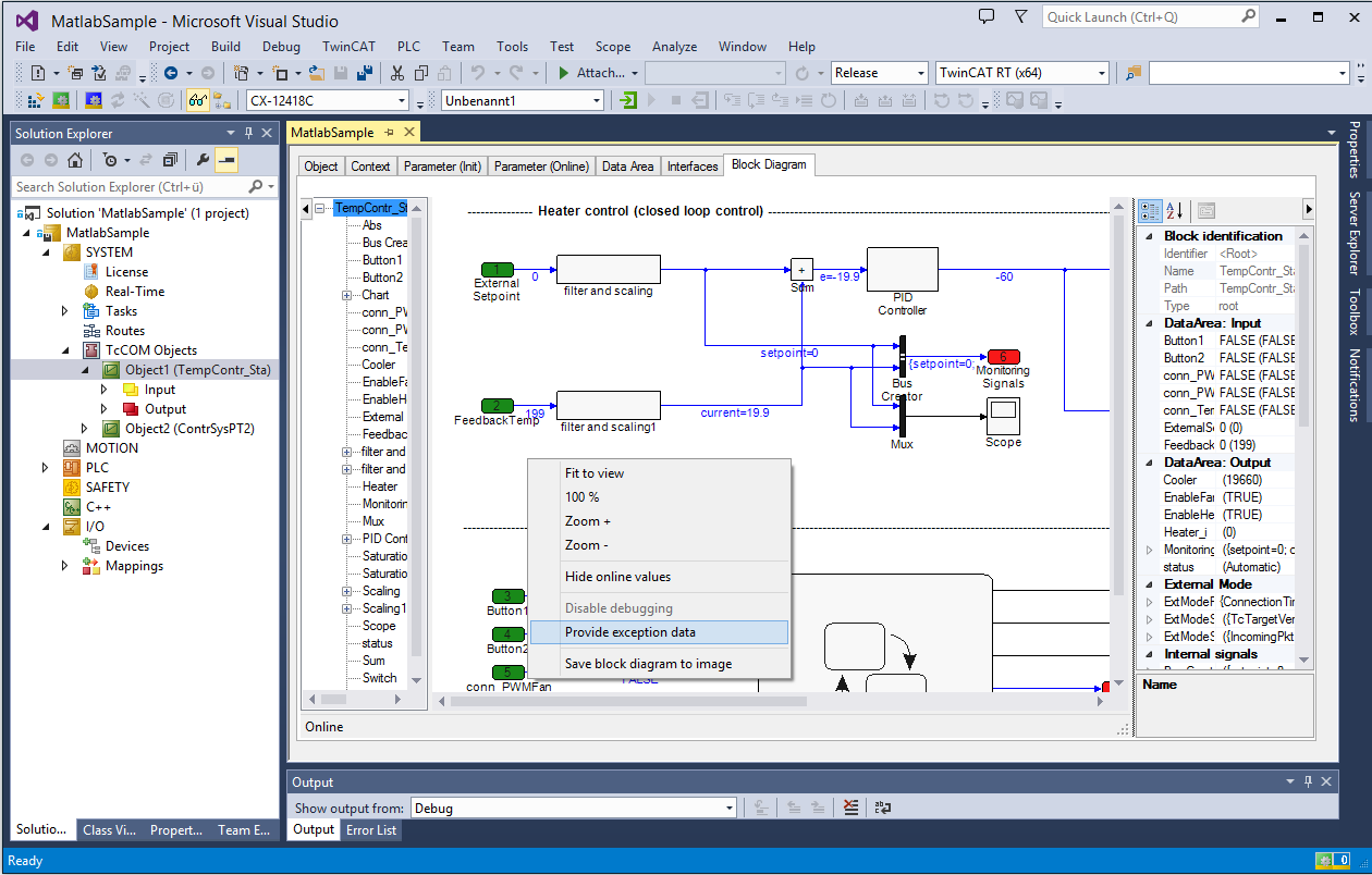

If you know the source code file and line number, you can highlight the location of the error in the block diagram as follows:
- A prerequisite for highlighting the error location within the block diagram is that debug information was generated (option Export block diagram debug information in the coder settings under Tc Advanced).
- 3. From the context menu of the block diagram select the entry Provide exception data:

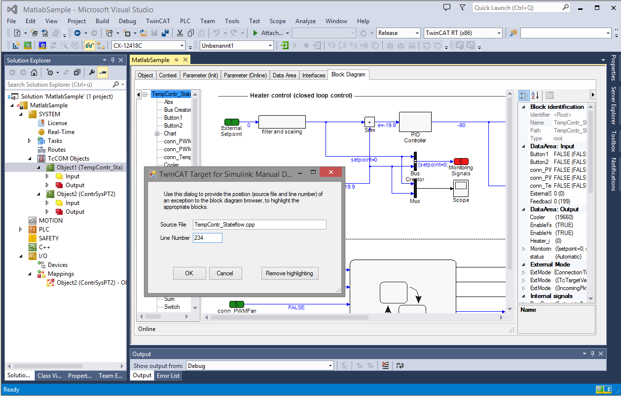

- 4. In the dialog that opens, enter the source code file and line number provided in the error message:
- 5. The name of the function block associated with the line number is displayed in red, and the function block itself is marked in bold:
