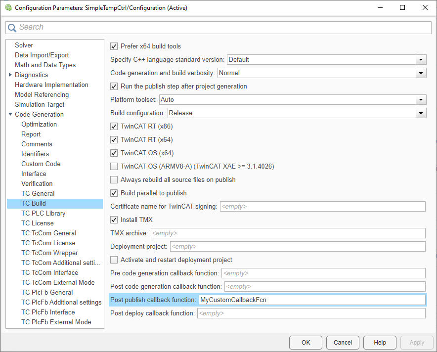

Working with callbacks
There are four different callback functions:
- Pre code generation callback function: Callback before the model is converted to C++ code.
- Post code generation callback function: Callback after the model has been converted to C++ code.
- Post publish callback function: Callback after the created C++ project has been built for the configured platforms.
- Post deploy callback function: Callback will be executed after the project specified in “Deployment Project” is updated.
Enter the name of your created MATLAB® function here to call it.
Your MATLAB® function is passed the ProjectExporter object as a transfer parameter:
