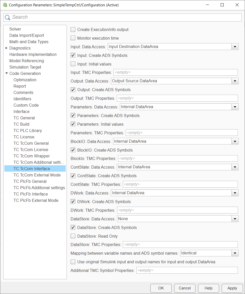

Configuration interface in Simulink®
Switch to Advanced mode to make the following parameters visible.
TwinCAT.ModuleGenerator.Settings.Change('ConfigurationLevel', 'Advanced')
The Data Access can be defined individually for each variable group named above. Selection options for DataAreas and module parameters are summarized in the following table:
Data Access | Access via ADS | Access via mapping | Access via Data Pointer |
None | No | No | No |
Module parameters | Yes | No | No |
Input Destination DataArea | Yes | Yes (with Output Source) | Yes |
Output Source DataArea | Yes | Yes (with Input Destination) | Yes |
Internal DataArea | Yes | No | No |
Standard DataArea | Yes | No | Yes |
Retain Source DataArea | Yes | Yes (with Retain Handler) | No |
Unlike DataAreas, Module parameters are not intended for cyclic (process) data exchange with other modules or I/Os. They are generally read or written asynchronously, e.g. via ADS. The parameters on the Parameters (Init) tab have an initial value that can be configured in the project and is written when the TcCOM instance is started. The parameters on Parameter (Online) on the other hand, have no configurable initial value and are typically used to monitor internal states.

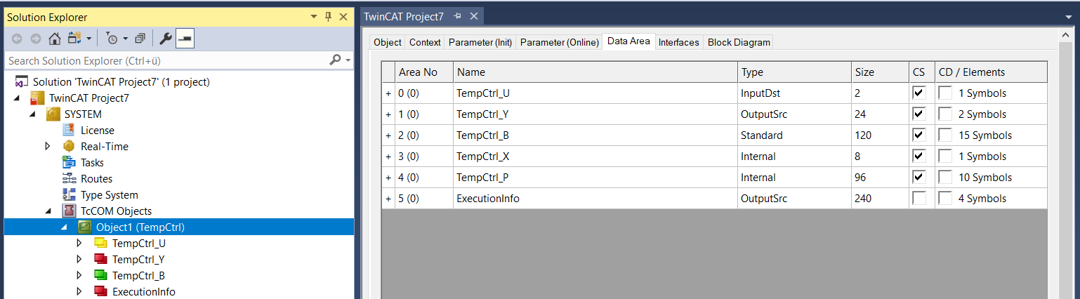

DataAreas can be found on the TcCOM instance on the DataArea tab. The exact type of the DataArea is also displayed here. Internal DataAreas are not created as process data image in the development environment.
Properties of the parameterization
The access via ADS is usually ReadOnly. Only the Inputs and Parameters groups can also be written via ADS.
Independently of this, it is possible to set for each group whether ADS symbol information (Create ADS Symbols) should be created for the respective group. If no ADS symbol information is available, the data can only be accessed by ADS via IndexGroup and IndexOffset.

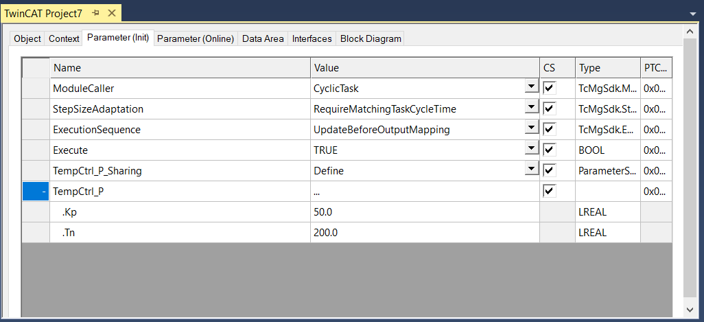

Via the option “Input: Initial values” you get an entry under “Parameter (Init)” in addition to the DataArea (for the cyclic data exchange). This way initial values for inputs can be realized. These values apply if the corresponding inputs have not been linked. Without these parameters, unlinked input values are always 0.
Via the option “Parameter: Initial values”, the parameters of the Simulink® model are also created as module parameters (structure <ModelName>_P) in addition to the DataArea setting.
![]() | Special case: DataArea for model parameters If the code interface is set to Reusable function (default), then no DataArea is created for model parameters, since the parameters are kept global for this case and thus shared between multiple instances. If “Parameter: Initial values” is selected, the parameter “<ModelParameterName>_Sharing” is created in addition to the entry for the model parameters at Parameter (Init). This parameter can only be set to “Define” for an instance of this TcCOM module class. All further instances must use “Inherit”. Since all instances share the parameters in this case, they all work with the parameter set in the “Definer”. The model parameter settings of the other instances are ignored. |
Monitor Execution Time: Creates a module parameter at Parameter (Online) and in the block diagram (right side). The execution time of the TcCOM can be read via this parameter. The measurement is updated with each call of the TcCOM, so that, for example, the execution time can be tracked precisely for each call via the TwinCAT Scope.
Create ExecutionInfo output: Creates an additional Output Source DataArea with information about the module call, see Exception handling.
DataStores: Variables from a Data Store Memory Block are stored in DWork by default. You can create an additional addressing of these variables when you create a DataArea for DataStores. No DataArea is created by default. For an example, see Shared memory between TcCOM instances.
