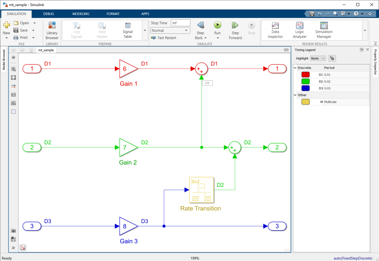

The following multirate system in Simulink® is considered for the descriptions of the options Multitask and Concurrent Execution. The model has an explicit and an implicit rate transition.

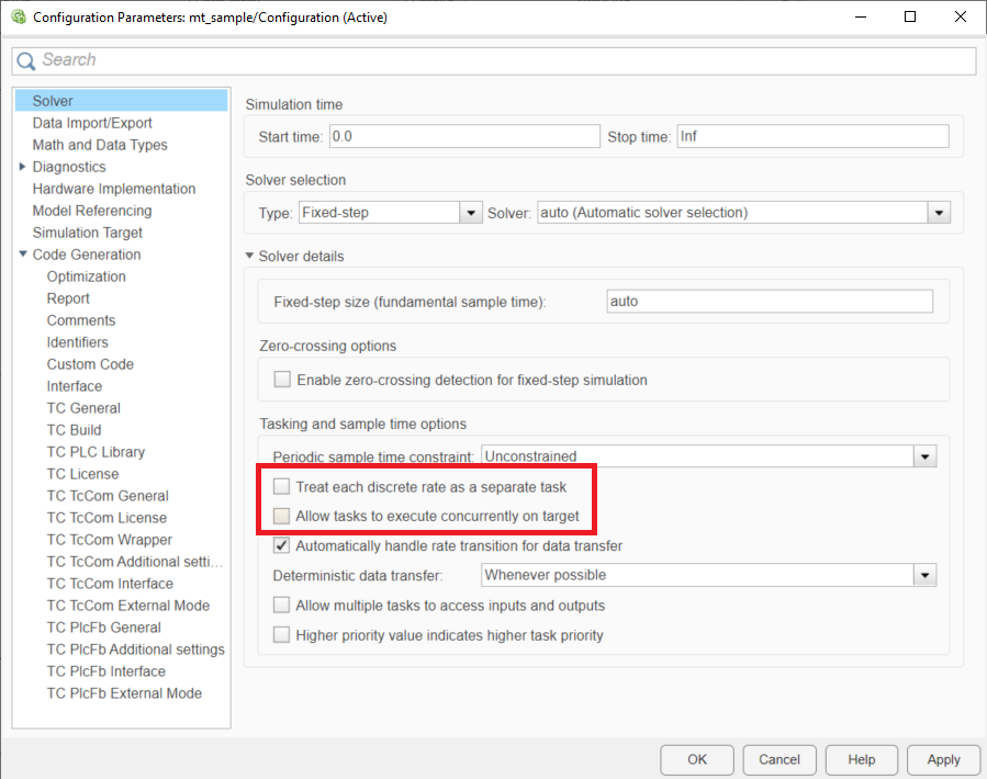

Select Solver under Configuration Parameters. You can choose from the following options:
- Treat each discrete rate as a separate task
- Allow tasks to execute concurrently on target
Treat each discrete rate as a separate task: Multitask

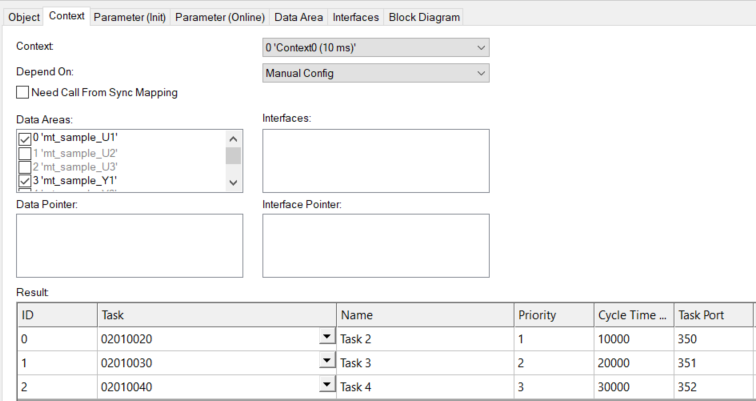

If a TcCOM object is created with the Treat each discrete rate as separate task option enabled, you can assign multiple task contexts to the object. There are three tasks in this case.
Inputs, outputs, and all further DataAreas are divided into these contexts. In this case, there are three input DataAreas and three output DataAreas.

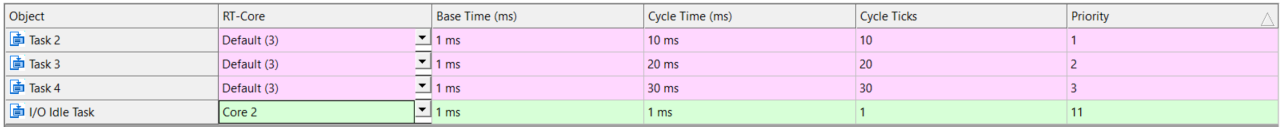

In this case, the cyclic tasks must all be allocated to the same core. The tasks are not processed in parallel.
The advantage over a TcCOM with only one task interface is that not all calculations now have to be completed within the fastest task cycle time (see Scheduling). If the above Simulink® model were created using the default settings and the Treat each discrete rate as separate task option were not selected, only one task with 10 ms (the fastest task) would be linkable. This means that all calculations must be completed within this time frame. When distributing to multiple tasks on the same core, this rule is disabled because tasks can interrupt each other (see Priorities).

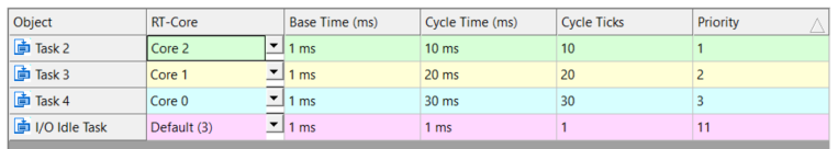

- All tasks are assigned to the same core.
- The fastest task must be assigned the highest priority (lowest priority value). The second fastest task must be assigned the second highest priority and so on.

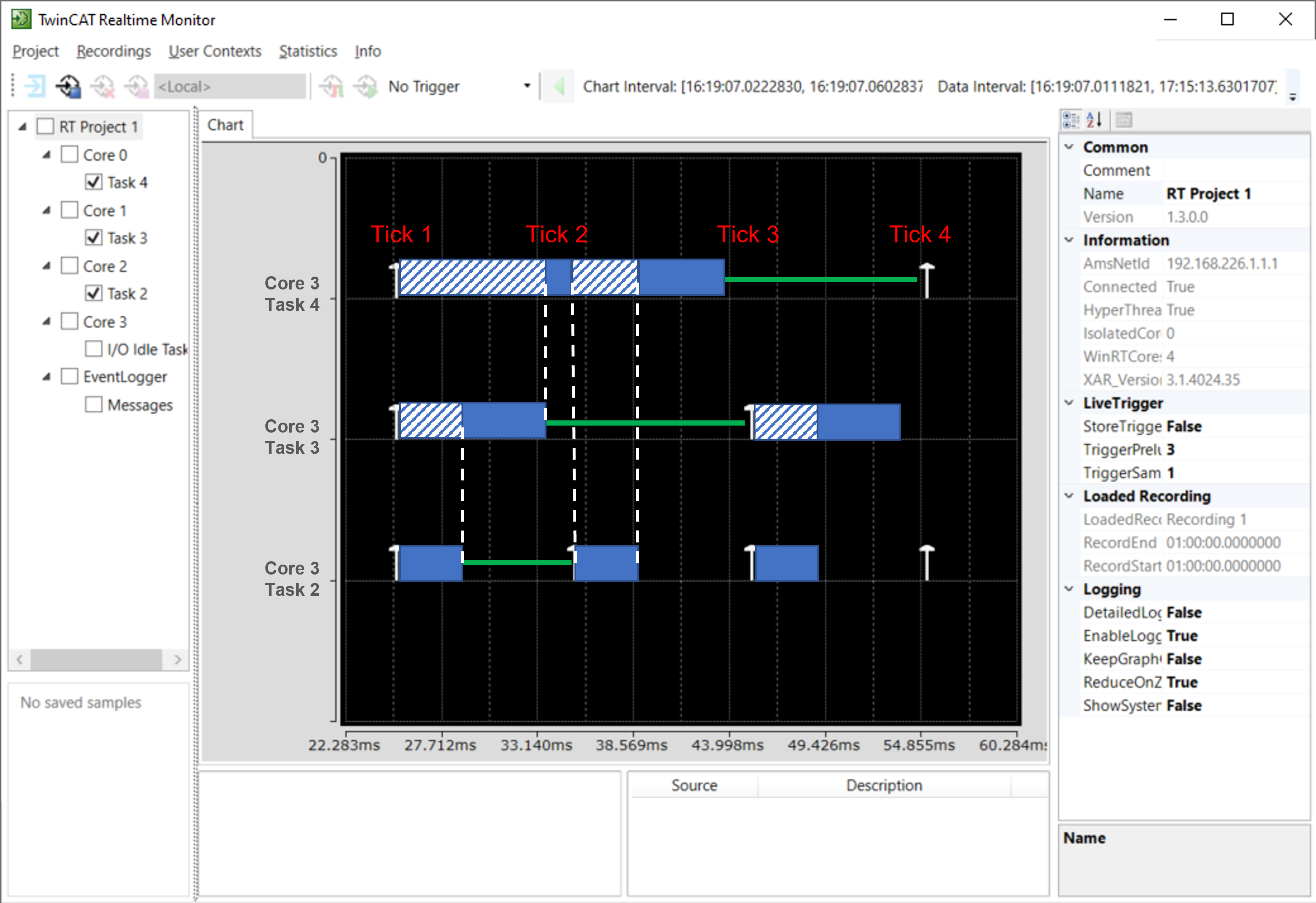

Scheduling Details:
The graphic below describes an example of how the computing times can be distributed. The hatched areas indicate that a task may be paused during this time due to a higher priority task. The solid blue area indicates that the task is executed. Please note that the areas were added to the real-time monitor image for clarity purposes only and are not actual images.
- Task 2, Task 3, and Task 4 are executed sequentially on the same core in Tick 1. Task 2 and Task 3 are executed without interruption. The execution of Task 4 is interrupted by the higher priority Task 2 in the transition to Tick 2.
- Task 2 is executed first in Tick 2. The execution of Task 4 is resumed after Task 2 is completed.
- Task 2 starts again and Task 3 follows in Tick 3.
If cycle timeouts occur and scheduling cannot be adhered to, the execution of the respective task context is skipped until all relevant contexts are in the appropriate state. In the TcCOM object this behavior can be observed via the online parameter SkippedExecutionCount.

- Tasks can be assigned to different cores.

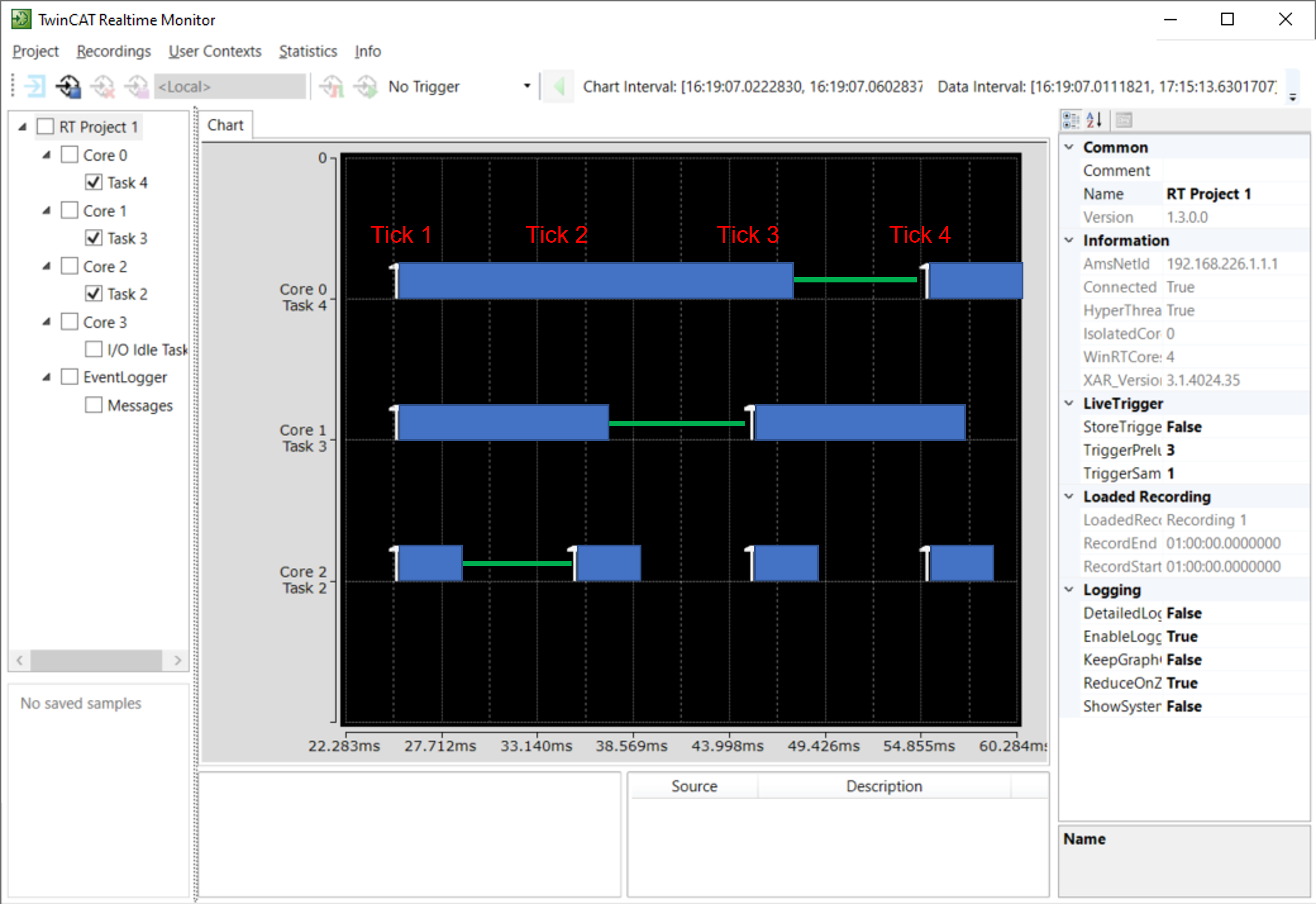

Scheduling details:
The graphic below describes an example of how the computing times can be distributed. The solid blue area indicates that the task is executed. Please note that the areas were added to the real-time monitor image for clarity purposes only and are not actual images.
- Task 2, task 3 and task 4 are executed in parallel on different cores in tick 1. The execution of task 2 must be completed by the start of tick 2.
- Task 2 is executed again in tick 2. Task 3 and task 4 may continue to work. The execution of task 2 and task 3 must be completed by the start of tick 3.
- Task 2 and task 3 are executed again in tick 3. Task 4 may continue to work. The execution of task 2 and task 4 must be completed by the start of tick 4.

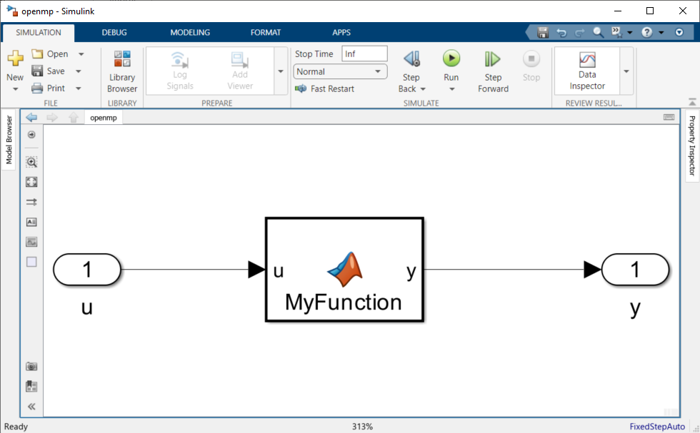

The following is a sample using a MATLAB® Function in Simulink®. A MATLAB® sample can be found in conjunction with the TE1401 TwinCAT Target for MATLAB® in the samples:
TwinCAT.ModuleGenerator.Samples.Start('Code parallelization with OpenMP').
The parfor command is used to parallelize the FOR loop in the MATLAB® function. In this case, the number of parallel workers is limited to 4.

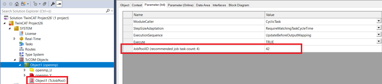

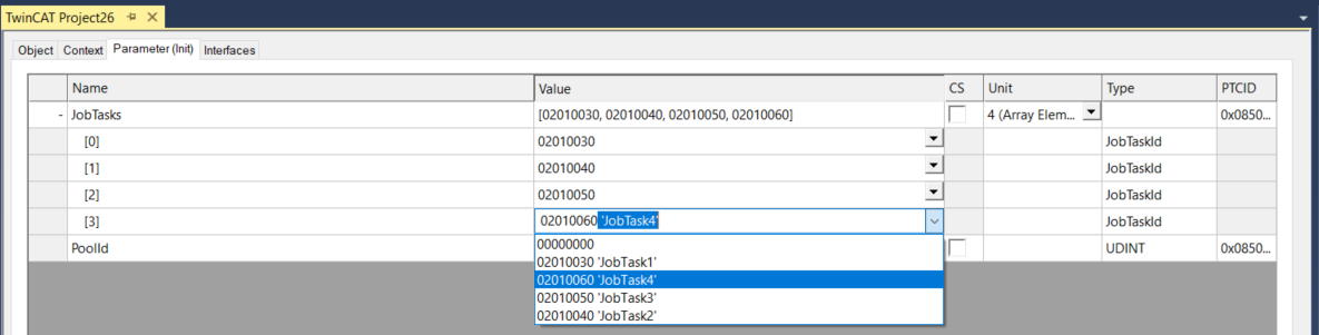

There is a parameter JobPoolID under Parameter (Init). Here, as far as known from the C/C++ code, it is also shown how many workers can work in parallel. A JobPool is an organization unit for JobTasks, which can be created in the Tasks node.
Accordingly, an object of type TcJobPool must be added under TcCOM Objects with “Add new item”. Under Parameter (Init) on the TcJobPool object, the JobPoolId is to be entered and a group of JobTasks is to be referenced. First define how many JobTasks the pool should combine and then select the JobTasks with the drop-down menu.

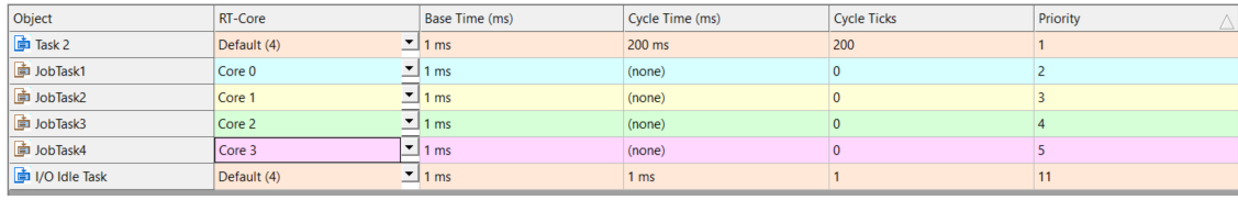

Under System > Realtime you can distribute JobTasks to different cores.
Execution in the configuration shown above then takes place as follows. Task 2 is executed on core 4 and cyclically drives the openmp object. The code fragments generated as openMP code can then outsource tasks to the configured JobTasks via the JobPool. When the JobTasks have finished their calculations, all partial results are bundled again and Task 2 on core 4 executes the code to the end.
