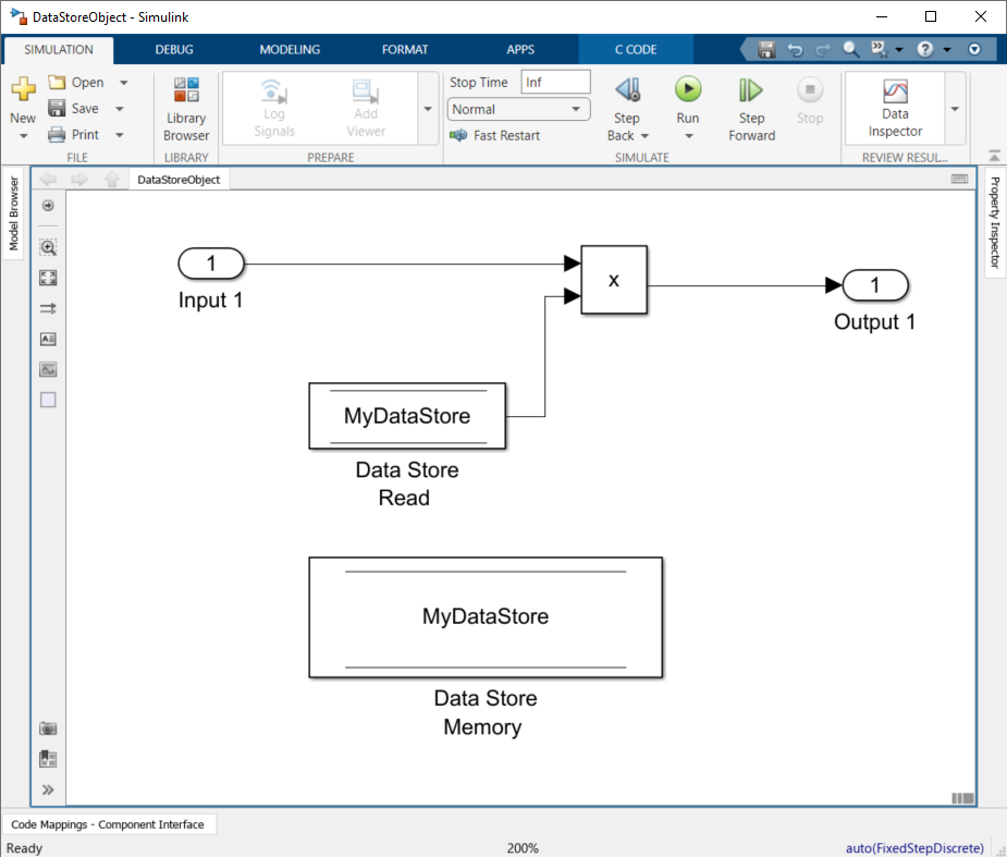

Model with DataStore
A Data Store Memory block is created in a model "DataStoreObject". In this sample with only one variable of type double. This variable is read with a Data Store Read, multiplied by an input and set to an output.
Shared memory between TcCOM instances 1:

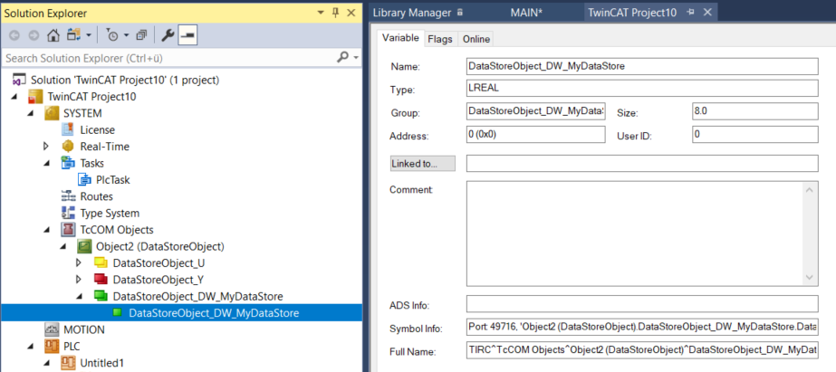

At TC TcCom Interface, the option DataStore: Data Access is changed from None to Standard DataArea and the Simulink® model is compiled into a TcCOM. If the object is instantiated in TwinCAT, the following representation is obtained:
Shared memory between TcCOM instances 2:
The DataStore DataArea is now displayed in the process image and contains a variable of type LREAL, which can be accessed via DataPointer.

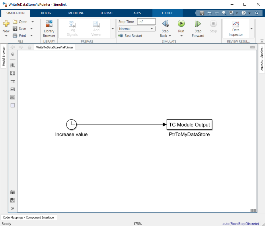

In a second Simulink® model, a double value is generated by a clock and this is set to the TC Module Output.
Shared memory between TcCOM instances 3:

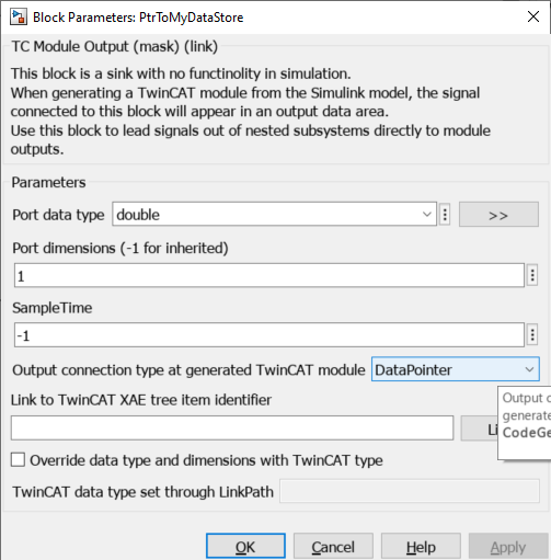

In the configuration of the TC Module Output, the connection type is set to DataPointer and the data type is set to double.
Shared memory between TcCOM instances 4:

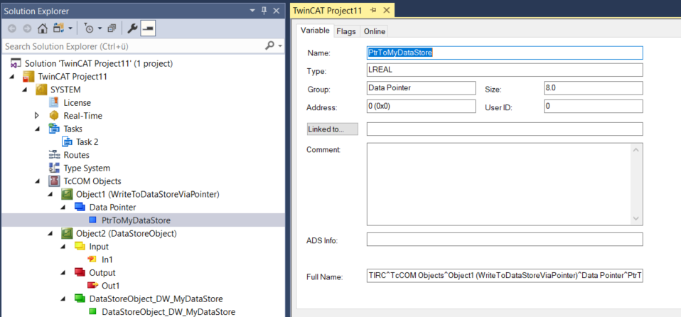

If this model is compiled into a TcCOM object, the following representation is obtained in TwinCAT:
Shared memory between TcCOM instances 5:
The name of the TC Module Output "PtrToMyDataStore" of type LREAL is now displayed under Data Pointer. This can now be linked by double-clicking on the DataStoreObject_DW_MyDataStore.
Both TcCOM instances should be called in the same task because the communication is not threadsafe.
Shared memory between TcCOM instances 6:
If different tasks are used, the user must ensure that data is consistent and is read or written at appropriate times.

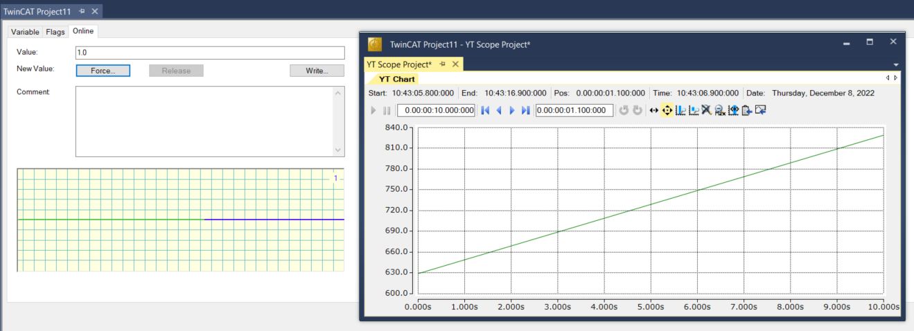

The behavior of the sample here is shown in the graphic below.
If the input In1 of the DataStore model is manually set to 1 and the output Out1 is observed via the TwinCAT Scope, an increasing straight line is seen. This means that the increasing value from the clock is written to the DataStore of the DataStoreObject-TcCOM via pointer.
Shared memory between TcCOM instances 7:
Shared memory between TcCOM instances 8:

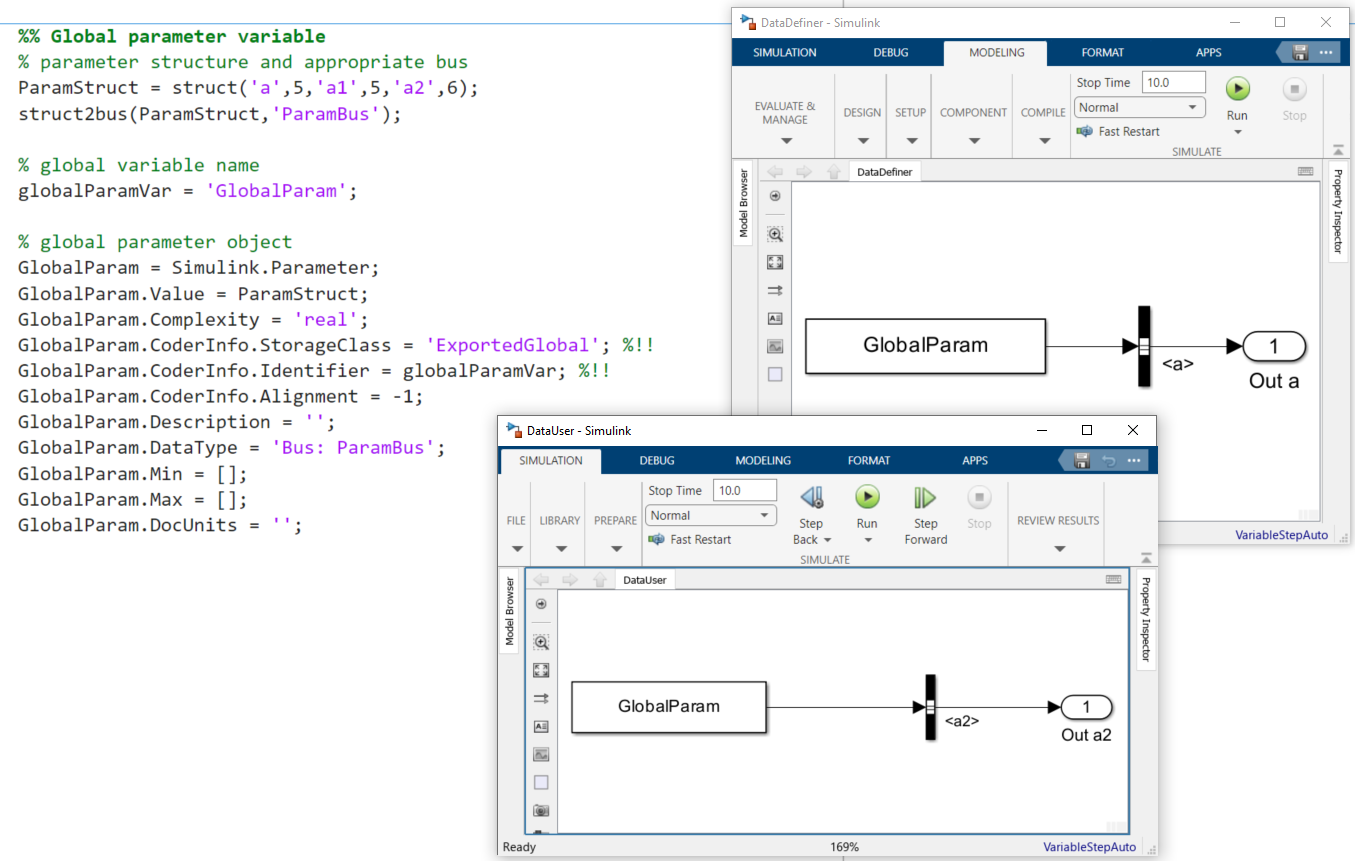

A Simulink® parameter GlobalParam is created, which contains a structure of 3 elements. The goal is to define this structure via a TcCOM object and to instantiate further TcCOM objects that access this structure via shared memory area, so that changes in the defining TcCOM arrive directly in all connected TcCOM instances.
Modeling in Simulink®
Two Simulink® models are created:
  1. “DataDefiner” model
  2. “DataUser” model
Furthermore, a Simulink® bus is defined and created as a Simulink® parameter named GlobalParam. The DataDefiner model determines the content of GlobalParam at the end, while the DataUser models only read the content.
Shared memory between TcCOM instances 10:
Note that the Storage Class definition of GlobalParam is set differently for the DataDefiner and DataUser below. For the DataDefiner, the Storage Class is set to Exported Global, while for the DataDefiner, the Storage Class is set to Imported Extern.

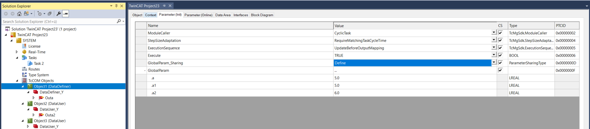

Configuration in TwinCAT XAE
Create one instance of the DataDefiner in the TwinCAT XAE (more are not allowed!). On the other hand, you can create as many DataUser instances as you like.
1. Set Parameter (Init) > Parameter GlobalParam_sharing for the DataDefiner to “Define”.
2. Set Parameter (Init) > Parameter GlobalParam_sharing for all DataUsers to “Inherit”.
3. Create a task.
4. Assign this task to all created instances.
Shared memory between TcCOM instances 11:
5. Activate the project.
Change the values of GlobalParam in the DataDefiner, e.g. via the Block Diagram, and observe the direct effect on the DataUser instances.
