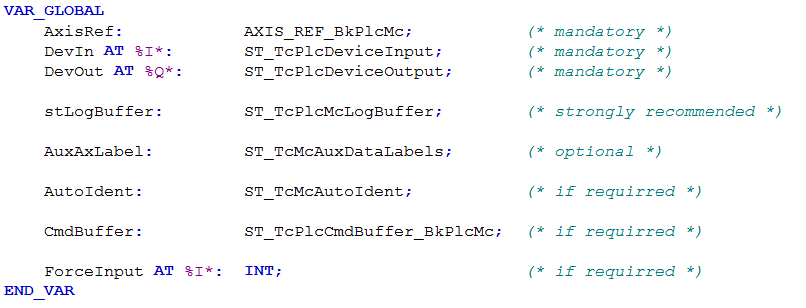

All function blocks work on a common axis reference, which must be created globally. If there is more than one axis, the axis references must be created as an array.
In addition to the axis reference (AXIS_REF_BkPlcMc), the I/O structures ST_TcPlcDeviceInput and ST_TcPlcDeviceOutput must be declared for each axis. Further optional elements are added, depending on the application.
To view messages a ST_TcPlcMcLogBuffer should be declared. This buffer is shared by all axes.
If other sensors such as pressure or load cells are used in the application in addition to position detection, the I/O value must be set in the application. The parameterization of the scaling can be managed in the fCustomerData[] section of the axis. For each axis 20 customer-specific data are provided in this section. This data is saved via the axis, loaded and displayed in the PLcMcManager. For the display in the PlcMcManager the label can be changed by declaring the structure ST_TcMcAuxDataLabels.
Sample for the data of an axis

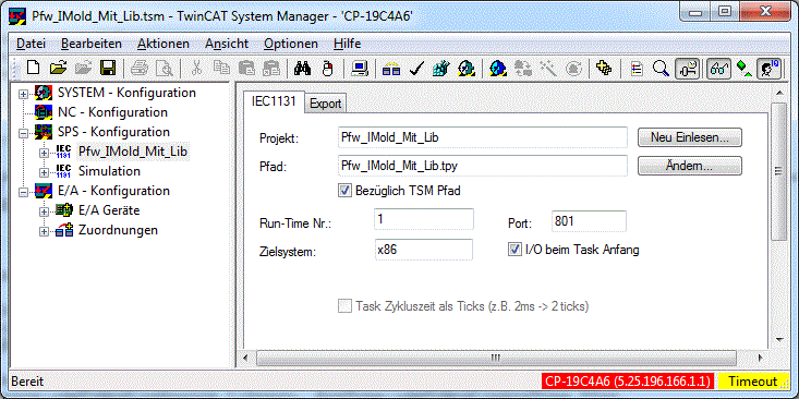

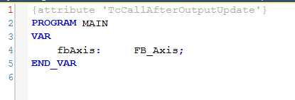

An attribute must be set in TwinCAT 3 so that the I/O is always read in with a constant time interval, regardless of the time required by the program.
In TwinCAT 2, the I/O flag at the start of the task must be set in the System Manager under PLC configuration.
In contrast to NC, the hydraulic axis itself (setpoint generator, controller, etc.) is calculated directly in the PLC. It is therefore recommended to set the cycle time of the task to less than 10 ms.

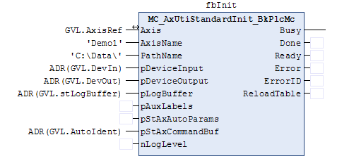

The PLCopen standard specifies that all Motion function blocks of the application are called with an instance of type AXIS_REF_BkPlcMc. For technical reasons, some axis components cannot be contained in such an instance, since they must be located in separate areas (e.g. process images). Other elements are optional and are only be added if required. To link them to the axis reference, they are transferred to an initialization function block of type MC_AxUtiStandardInit_BkPlcMc.
When called for the first time, the function block links the input and output structures and all optional elements with the axis reference. Variables that have to be passed as addresses are marked with the prefix "p". The function block should be called cyclically to check the pointer addresses.
![]() | It is not permitted to bind an instance of ST_TcPlcDeviceInput, ST_TcPlcDeviceOutput or ST_TcMcAutoUdent to multiple axes. It is not permitted to connect more than one instance of ST_TcMcLogBuffer to axes. |
The function block loads the parameters from the given file path and transfers them to the axis reference. All parameters are stored in binary form in an Axis name.dat file.
Once the parameters have been loaded successfully, the bParamsEnable flag in the axis reference becomes TRUE. Only now is the use of parameters that have not yet been defined ruled out, and all other axis-related function blocks may be called.

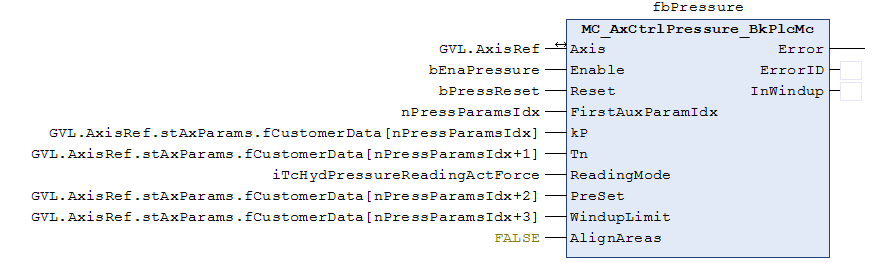

Pressure or force controllers are used in many applications with hydraulic axes. As an example, an MC_AxCtrlPressure_BkPlcMc function block is shown here.
In the active state, the function block overwrites the output of the setpoint generator. In order for the controller response to take effect, it must be called up before linearization.

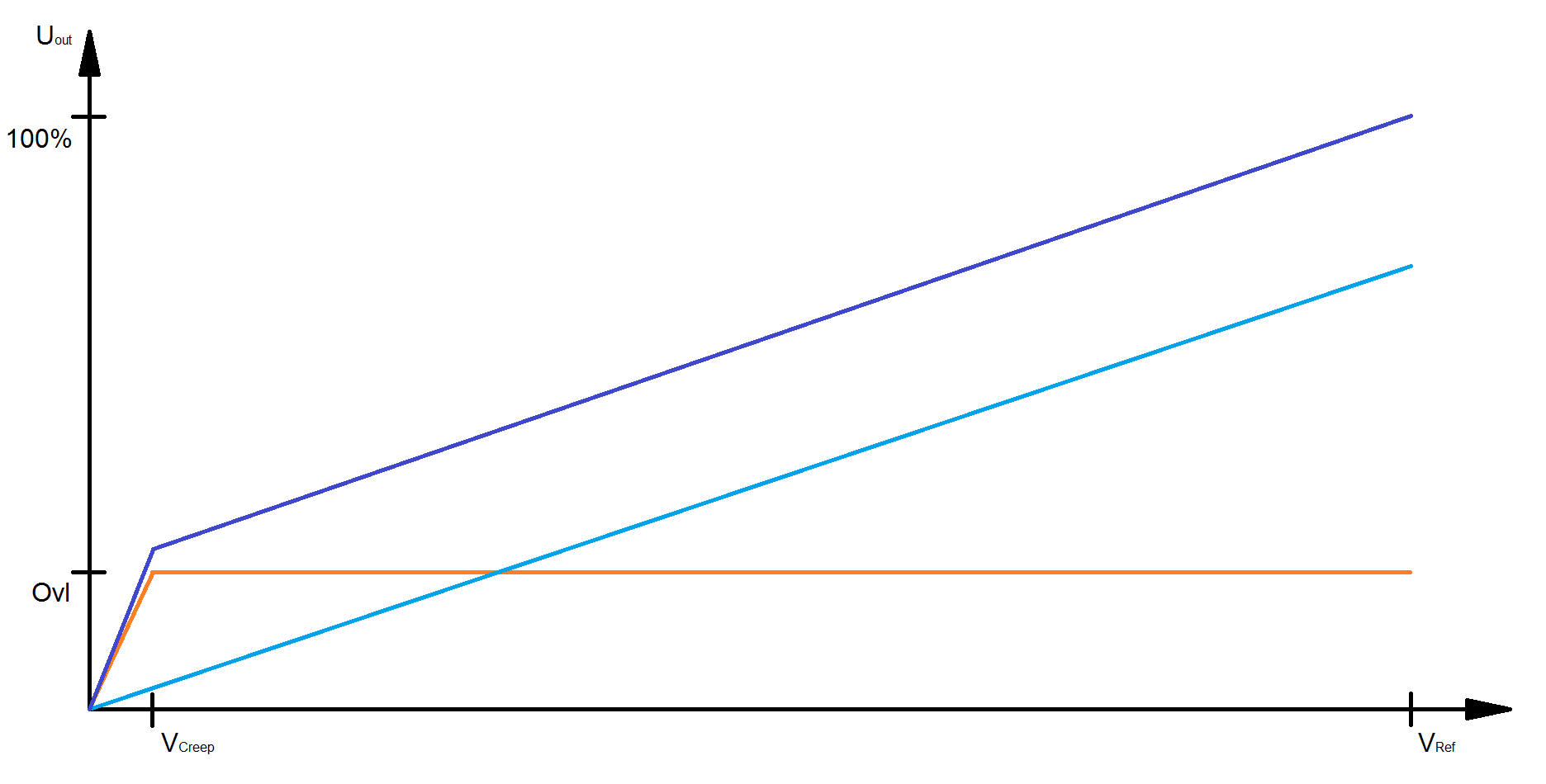

An active overlap compensation is selected such that it is ramped linearly from zero to the set overlap compensation Ovl between 0 and VCreep. It is fully effective for the remaining area.
The direction dependency is compensated. The output velocity is multiplied by fAreaRatio from the axis parameters if the velocity is positive and fAreaRatio ≥ 1.0. If the velocity is negative and fAreaRatio ≤ 1.0 division is applied.
The output is formed by adding the weighted target velocity, the controller output, the active overlap compensation and the offset correction.

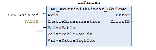

The library provides the function block MC_AxRtFinishLinear_BkPlcMc for this linearization with higher resolution.
If the use of the characteristic curve is not enabled or not possible, an internal function block is used for sectional linearization. This is the case if at least one of the following reasons applies:
- FALSE is transferred at the enable input of the function block.
- No instance of type ST_TcMcAutoIdent has been linked to the axis reference.
- bLinTabAvailable in the axis parameters is FALSE: The characteristic curve is not valid.
Otherwise, the target velocity weighted with the pre-control and the controller output are added to the output velocity. The two characteristic curve points closest to the calculated value are determined and the output value is formed by intermediate interpolation and addition of the offset correction.

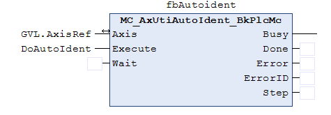

The function block MC_AxUtiAutoIdent_BkPlcMc supports the measurement of a characteristic curve by means of a standardized automatic sequence. The parameters to be set for this are stored in the structure ST_TcMcAutoIdent. If a characteristic curve measurement and a characteristic curve-based linearization are to be used, such an element must be created and connected to the axis reference.
![]() | An MC_AxUtiAutoIdent_BkPlcMc function block must be called after the MC_AxRtFinishLinear_BkPlcMc function block and before the MC_AxRtDrive_BkPlcMc function block of the axis. |

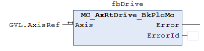

At this point, the control values for the axis are available as physical or standardized parameters. Only the MC_AxRtDrive_BkPlcMc function block determines an output parameter that represents these parameters in a form that is converted to the desired response by the device used. The method used and its parameters are set in the parameter structure of the axis reference.

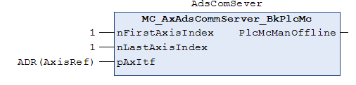

The PlcMcManager is connected via the TwinCAT ADS service. Since this allows only one port per application, all axes must use a common connection. Multiple instances of this function block are not permitted.
The sample shown applies to an application with only one axis. Multi-axis projects must combine the axis references in an array whose address and first and last index are transferred.
This FB must be called independently of whether axes can load their parameters.
