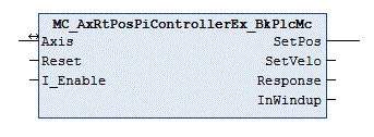

MC_AxRtPosPiControllerEx_BkPlcMc (ab V3.0.40)
The function block can be used as an alternative to the default position controller. It is called after the MC_AxRuntime_BkPlcMc() function block (setpoint generator and default position controller). This arrangement overwrites the responses of the default position controller.
Inputs
Reset: BOOL:=FALSE;
I_Enable: BOOL:=FALSE;
Name | Type | Description |
Reset | BOOL | This input deletes all internal and external controller responses. |
I_Enable | BOOL | This input controls the activity of the I part. |
Inputs/outputs
VAR_INOUT
Axis: Axis_Ref_BkPlcMc;
Axis | Axis_Ref_BkPlcMc | Here, the address of a variable of type Axis_Ref_BkPlcMc should be transferred. |
Outputs
SetPos: LREAL;
SetVelo: LREAL;
Response: LREAL;
InWindup: BOOL;
SetPos | LREAL | [mm] The set position that becomes effective at the internal controller. |
SetVelo | LREAL | [mm/s] The set velocity that becomes effective at the internal controller. |
Response | LREAL | [mm/s] The controller response. |
InWindup | BOOL | Here, the limitation of the I part that has become active is signaled. |

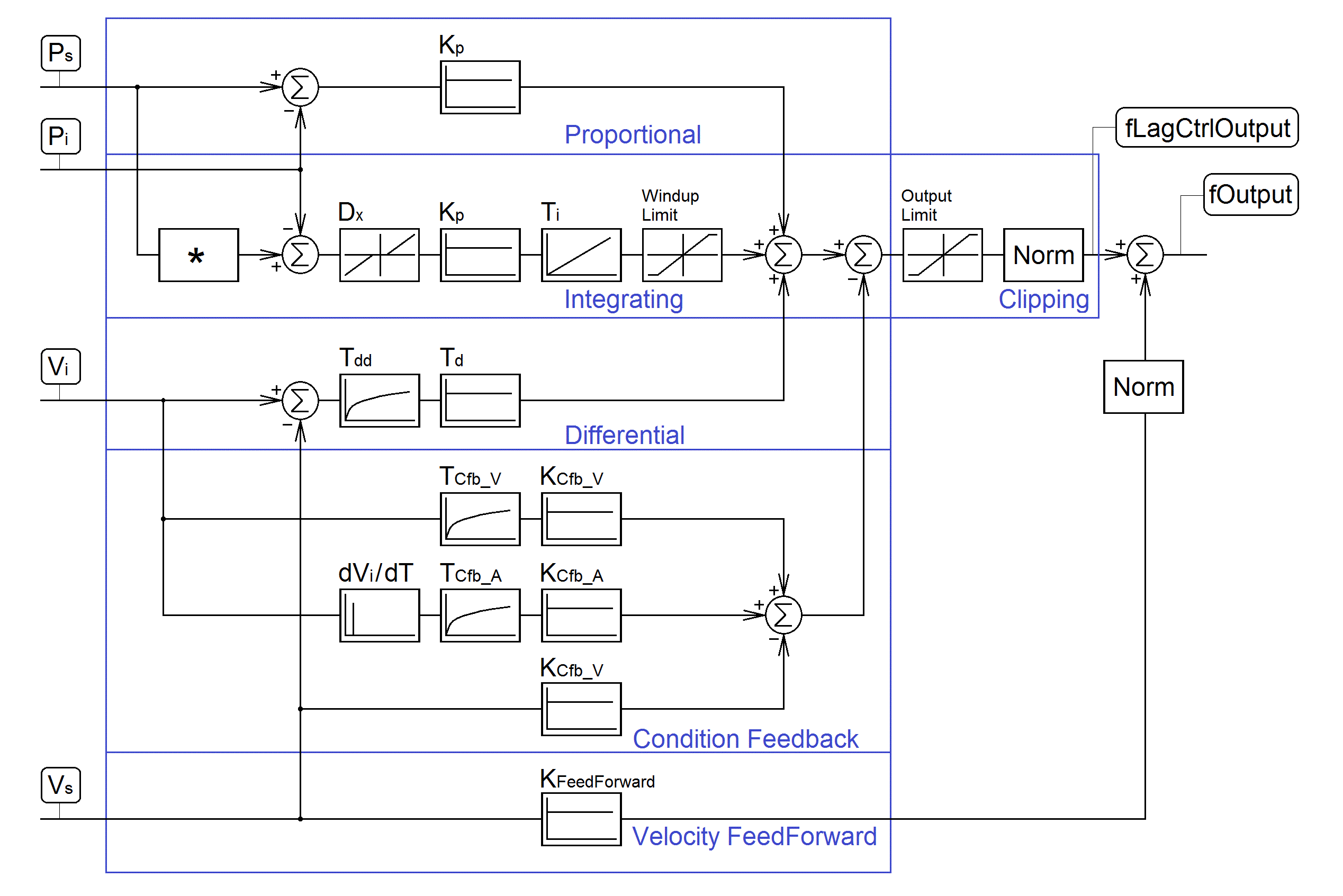

Structure of the controller
The component marked with an asterisk * prepares the set value for the I component of the controller when the setpoint generator is path-controlled. This is necessary because the set position provided by the setpoint generator jumps to the target position when the braking distance is reached. With time-controlled setpoint generator, the component is transparent.
![]() | Not shown here: TRUE on Reset, or a missing controller enable of the axis deletes both the I component and the controller output. |
The I component has a threshold value Dx, which prevents a response to small deviations. For technical reasons, this parameter is limited to at least 2/3 incremental weighting of the encoder. If the I component is to be inactive, set Ti to zero.
The implementation of the D component takes advantage of the fact that the differentiated set position is provided by the setpoint generator. An actual velocity is determined by differentiating the actual position. Under this condition, the differentiation time constant Td acts as a proportionality factor. If the D component is to be inactive, set the time constant Td to zero.
Three branches are implemented in the condition feedback:
- Velocity activation: The actual velocity is filtered and activated with a weighting factor. As it is subtracted, it has an attenuating effect. If the connection is to be inactive, set KCfb_V to zero.
- Acceleration activation: The actual velocity is differentiated, filtered and activated with a weighting factor. As it is subtracted, it has an attenuating effect. If the connection is to be inactive, set KCfb_A to zero.
- A velocity activation generates a statically effective reduction of the velocity pre-control. In the case of path-controlled positioning, this generates a noticeable velocity deviation. With time-controlled positioning, this effect is compensated, as far as possible, by the continuously active position control. This undesirable side-effect of velocity feedback is eliminated by automatic adjustment of the pre-control. Deactivating the velocity activation also deactivates this compensation.
Velocity pre-control is activated after the controller. The weighting is fixed at 1.0 when the setpoint generator is path-controlled and cannot be reduced.
If linearization is activated, it takes place after the controller and is not shown here.
