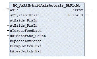

MC_AxRtHybridAxisActuals_BkPlcMc (from V3.0.44)
The function block determines the essential actual values of a servo-electric/hydraulic hybrid axis.
