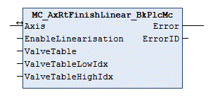

MC_AxRtFinishLinear_BkPlcMc (from V3.0.16)
The function block deals with the adjustment of the generated control value to the special features of the axis, taking into account a characteristic curve.

The function block investigates the axis interface that has been passed to it every time it is called. A number of problems may be detected:
- EnableLinearisation is FALSE.
- There is no ValveTable available.
- ValveTableLowIdx is less than 0.
- ValveTableHighIdx is less than or equal to ValveTableLowIdx.
In these cases an MC_AxRtFinish_BkPlcMc function block is called internally, and its outputs are passed on. Otherwise the table linearization for the axis is performed. Note the following special characteristics:
- The parameter for compensating the directional dependence (area ratio, gravity etc.) of the axis velocity has no effect. This compensation should be taken into account in the table.
- The parameters for compensating a kink in the characteristic curve have no effect. This compensation should be taken into account in the table.
- The parameter for the overlap compensation has no effect. This compensation should be taken into account in the table.
- A pressing power output or an offset compensation cannot be realized through a linearization. The corresponding parameters are active.
