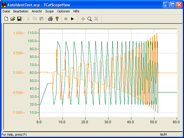

Example: Diagram of a characteristic curve determination in TwinCAT ScopeView:

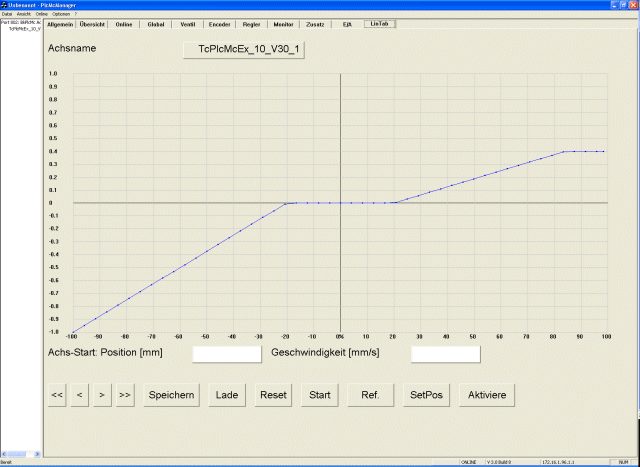

Example: Display of a linearization in the PlcMcManager:
The characteristic curve determined in this way can be used with an MC_AxRtFinishLinear_BkPlcMc function block for linearization at runtime.
![]() | The characteristic curve is stored in the parameter file of the axis and automatically read on system startup. |
Irrespective of that, the linearization table can be imported from a text or binary file with an MC_LinTableImportFromAsciFile_BkPlcMc or MC_LinTableImportFromBinFile_BkPlcMc function block, or exported with an MC_LinTableExportToAsciFile_BkPlcMc or MC_LinTableExportToBinFile_BkPlcMc function block.
