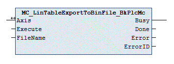

MC_LinTableExportToBinFile_BkPlcMc
The function block exports a linearization table to a file in binary format.
Inputs
Execute: BOOL:=FALSE;
FileName: STRING(255):=’’;
Name | Type | Description |
Execute | BOOL | A rising edge initiates the export. |
FileName | STRING |
Inputs/outputs
VAR_INOUT
Axis: Axis_Ref_BkPlcMc;
Axis | Axis_Ref_BkPlcMc | Here, the address of a variable of type Axis_Ref_BkPlcMc should be transferred. |
Outputs
Busy: BOOL;
Done: BOOL;
Error: BOOL;
ErrorID: UDINT;
Busy | BOOL | Indicates that a command is being processed. |
Done | BOOL | This indicates successful identification. |
The function block generates a file in the format expected by MC_LinTableImportFromBinFile_BkPlcMc.
