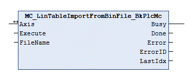

MC_LinTableImportFromBinFile_BkPlcMc
The function block imports a linearization table from a file in binary format.
