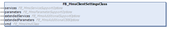

FB_MmsClientSettingsClass
FB_MmsClientSettingsClass 1:
The function block FB_MmsClientSettingsClass is used for the configuration of the MMS communication layer.
Namespace: Tc3_Mms

FUNCTION_BLOCK FB_MmsClientSettingsClass EXTENDS FB_UlosiClientSettingsClass IMPLEMENTS I_MmsClientSettingsClass
FB_MmsClientSettingsClass 2: Interfaces

FB_MmsClientSettingsClass 4: Inputs
Type
Initial value
services
FB_MmsServiceSupportOptions
.nUsedBits := cMmsServicesSupportOptionsBitSize (* default: 85 *),
.bStatus := TRUE,
.bGetNameList := TRUE,
.bIdentify := TRUE,
.bRead := TRUE,
.bWrite := TRUE,
.bGetVariableAccessAttributes := TRUE,
.bDefineNamedVariableList := TRUE,
.bGetNamedVariableListAttributes := TRUE,
.bDeleteNamedVariableList := TRUE,
.bGetDomainAttributes := TRUE,
.bInformationReport := TRUE,
.bConclude := TRUE,
.bCancel := TRUE
Object for the configuration of the supported MMS protocol services.
parameters
FB_MmsParameterSupportOptions
.nUsedBits := .cMmsParameterSupportOptionsBitSize (* default := 11 *),
.bStr1 := TRUE,
.bStr2 := TRUE,
.bVnam := TRUE,
.bValt := TRUE,
.bVlis := TRUE
Object for the configuration of the supported MMS protocol parameters.
extendedServices
FB_MmsAdditionalSupportOptions
.nUsedBits := cMmsAdditionalSupportOptionsBitSize (* default := 0, not used *)
Object for the configuration of the additionally supported MMS protocol services.
extendedParameters
FB_MmsAdditionalCBBOptions
.nUsedBits := cMmsAdditionalCbbOptionsBitSize (* default := 0, not used *)
Object for the configuration of the additionally supported MMS-CBB protocol parameters.
