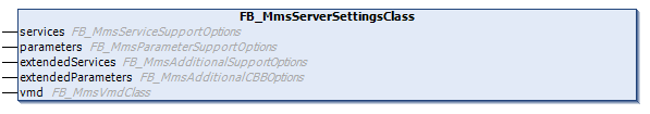

FB_MmsServerSettingsClass
The function block FB_MmsServerSettingsClass is used for the configuration of the MMS communication layer.
Namespace: Tc3_Mms
Library: Tc3_Mms (Tc3_Mms.compiled-library)
Inheritance hierarchy
FB_SocketServerSettingsClass -> FB_TpktServerSettingsClass -> FB_Rfc1006ServerSettingsClass -> FB_UlosiServerSettingsClass -> FB_MmsServerSettingsClass
FUNCTION_BLOCK FB_MmsServerSettingsClass EXTENDS FB_UlosiServerSettingsClass IMPLEMENTS I_MmsServerSettingsClass
Interfaces
Type | Description |
Interface for configuring the MMS communication layer. |
Inputs
Name | Type | Initial value | Description |
services | .nUsedBits := cMmsServicesSupportOptionsBitSize (* default: 85 *), | Object for the configuration of the supported MMS protocol services. | |
parameters | .nUsedBits := .cMmsParameterSupportOptionsBitSize (* default := 11 *), | Object for the configuration of the supported MMS protocol parameters. | |
extendedServices | .nUsedBits := cMmsAdditionalSupportOptionsBitSize (* default := 0, not used *) | Object for the configuration of the additionally supported MMS protocol services. | |
extendedParameters | .nUsedBits := cMmsAdditionalCbbOptionsBitSize (* default := 0, not used *) | Object for the configuration of the additionally supported MMS-CBB protocol parameters. |
