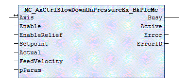

MC_AxCtrlSlowDownOnPressureEx_BkPlcMc
The function block brakes an axis in such a way that the actual value in Actual does not exceed the setpoint specified in Setpoint.

Inputs
Enable: BOOL:=FALSE;
EnableRelief: BOOL:=FALSE;
Setpoint: LREAL;
Actual: LREAL;
FeedVelocity: LREAL:=0.0;
pParam: POINTER TO ST_TcPctrlParam:=0;

Inputs/outputs
VAR_INOUT
Axis: Axis_Ref_BkPlcMc;

Outputs
Busy: BOOL;
Active: BOOL;
Error: BOOL;
ErrorID: UDINT;
