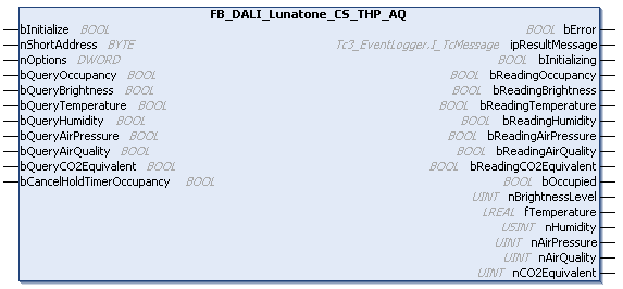

The function block FB_DALI_Lunatone_CS_THP_AQ represents the DALI-2 Sensor CS Integration THP-AQ from Lunatone.
This outputs an occupancy signal (instance 0), a brightness value (instance 1), a temperature value (instance 2), a value for the relative humidity (instance 3), a value for the air pressure (instance 4), a value for the air quality (instance 5) and a value for the calculated CO2 equivalent (instance 6).

FB_DALI_Lunatone_CS_THP_AQ 4: Inputs

FB_DALI_Lunatone_CS_THP_AQ 5: Outputs
