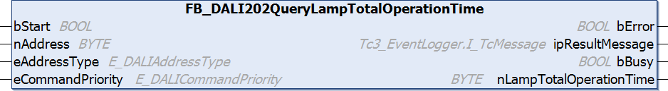

FB_DALI202QueryLampTotalOperationTime
FB_DALI202QueryLampTotalOperationTime 1:
The function block reads the variable lampTotalOperationTime from the DALI control gear.
The variable can be reset again using the function block FB_DALI202ResetLampTime.
FB_DALI202QueryLampTotalOperationTime 2:
Prior to the DALI command QUERY LAMP TOTAL OPERATING TIME, the function block sends the DALI command ENABLE DEVICE TYPE 1, as is necessary for application extended commands (see also FB_DALI102EnableDeviceType).
The output nLampTotalOperationTime only contains a valid value if the function block was executed without errors (bError = FALSE).
FB_DALI202QueryLampTotalOperationTime 3: Inputs
  bStart            : BOOL;
  nAddress          : BYTE;
Type
bStart
nAddress
BYTE
eAddressType
E_DALIAddressType
eCommandPriority
E_DALICommandPriority
FB_DALI202QueryLampTotalOperationTime 4:
FB_DALI202QueryLampTotalOperationTime 5: Outputs
  nLampTotalOperationTime : BYTE;
Type
ipResultMessage
I_TcMessage
bBusy
BYTE
Total operation time of the lamp from the DALI control gear (see lampTotalOperationTime).
FB_DALI202QueryLampTotalOperationTime 6: Properties
Type
Access
Initial value
ipDALICommunication
I_DALICommunication
Get, Set
NULL
Requirements
Development environment
Required PLC library
TwinCAT from v3.1.4024.35
Tc3_DALI from v3.13.0.0
