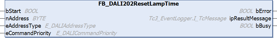

FB_DALI202ResetLampTime
FB_DALI202ResetLampTime 1:
The function block sets the variables lampEmergencyTime and lampTotalOperationTime to 0.
FB_DALI202ResetLampTime 2:
Prior to the DALI command RESET LAMP TIME, the function block sends the DALI command ENABLE DEVICE TYPE 1, as is necessary for application extended commands (see also FB_DALI102EnableDeviceType).
FB_DALI202ResetLampTime 3:
The function block sends the DALI command RESET LAMP TIME twice, as required by the DALI standard for certain DALI commands.
FB_DALI202ResetLampTime 4: Inputs
  bStart            : BOOL;
  nAddress          : BYTE;
Type
bStart
nAddress
BYTE
eAddressType
E_DALIAddressType
eCommandPriority
E_DALICommandPriority
FB_DALI202ResetLampTime 5:
FB_DALI202ResetLampTime 6: Outputs
Type
ipResultMessage
I_TcMessage
bBusy
FB_DALI202ResetLampTime 7: Properties
Type
Access
Initial value
ipDALICommunication
I_DALICommunication
Get, Set
NULL
Requirements
Development environment
Required PLC library
TwinCAT from v3.1.4024.35
Tc3_DALI from v3.13.0.0
