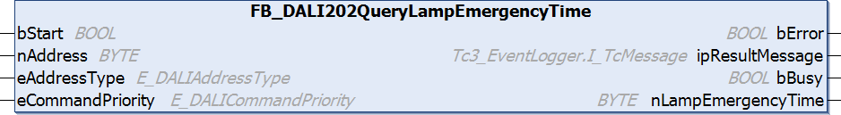

FB_DALI202QueryLampEmergencyTime 1:
The function block reads the variable lampEmergencyTime from the DALI control gear.
The variable can be reset again using the function block FB_DALI202ResetLampTime.
FB_DALI202QueryLampEmergencyTime 2:
Prior to the DALI command QUERY LAMP EMERGENCY TIME, the function block sends the DALI command ENABLE DEVICE TYPE 1, as is necessary for application extended commands (see also FB_DALI102EnableDeviceType).
The output nLampEmergencyTime contains a valid value only if the function block was executed without errors (bError = FALSE).
FB_DALI202QueryLampEmergencyTime 3: Inputs
  bStart            : BOOL;
  nAddress          : BYTE;
Type
bStart
nAddress
BYTE
eAddressType
E_DALIAddressType
eCommandPriority
E_DALICommandPriority
FB_DALI202QueryLampEmergencyTime 4:
FB_DALI202QueryLampEmergencyTime 5: Outputs
  nLampEmergencyTime      : BYTE;
Type
ipResultMessage
I_TcMessage
bBusy
nLampEmergencyTime
BYTE
Emergency operation time of the lamp from the DALI control gear (see lampEmergencyTime).
FB_DALI202QueryLampEmergencyTime 6: Properties
Type
Access
Initial value
ipDALICommunication
I_DALICommunication
Get, Set
NULL
Requirements
Development environment
Required PLC library
TwinCAT from v3.1.4024.35
Tc3_DALI from v3.13.0.0
