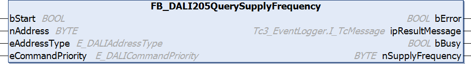

FB_DALI205QuerySupplyFrequency
FB_DALI205QuerySupplyFrequency 1:
The function block reads the current frequency of the supply voltage from the DALI control gear (see supplyFrequency).
bError is set to TRUE if the DALI control gear returns the value 255 (MASK). In this case, the value cannot be determined by the DALI control gear.
FB_DALI205QuerySupplyFrequency 2:
Prior to the DALI command QUERY SUPPLY FREQUENCY, the function block sends the DALI command ENABLE DEVICE TYPE 4, as is necessary for application extended commands (see also FB_DALI102EnableDeviceType).
The output nSupplyFrequency only contains a valid value if the function block was executed without errors (bError = FALSE).
FB_DALI205QuerySupplyFrequency 3: Inputs
  bStart            : BOOL;
  nAddress          : BYTE;
Type
bStart
nAddress
BYTE
eAddressType
E_DALIAddressType
eCommandPriority
E_DALICommandPriority
FB_DALI205QuerySupplyFrequency 4:
FB_DALI205QuerySupplyFrequency 5: Outputs
  nSupplyFrequency        : BYTE;
Type
ipResultMessage
I_TcMessage
bBusy
nSupplyFrequency
BYTE
Returns the current frequency of the supply voltage (see supplyFrequency).
