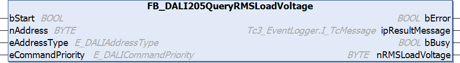

The function block reads the root mean square of the load voltage from the DALI control gear (see rmsLoadVoltage).
bError is set to TRUE if the DALI control gear returns the value 255 (MASK). In this case, the value cannot be determined by the DALI control gear.
FB_DALI205QueryRMSLoadVoltage 2:
Prior to the DALI command QUERY RMS LOAD VOLTAGE, the function block sends the DALI command ENABLE DEVICE TYPE 4, as is necessary for application extended commands (see also FB_DALI102EnableDeviceType).
The output nRMSLoadVoltage only contains a valid value if the function block was executed without errors (bError = FALSE).
FB_DALI205QueryRMSLoadVoltage 3: Inputs
  bStart            : BOOL;
  nAddress          : BYTE;
Type
bStart
nAddress
BYTE
eAddressType
E_DALIAddressType
eCommandPriority
E_DALICommandPriority
FB_DALI205QueryRMSLoadVoltage 4:
FB_DALI205QueryRMSLoadVoltage 5: Outputs
  nRMSLoadVoltage         : BYTE;
Type
ipResultMessage
I_TcMessage
bBusy
nRMSLoadVoltage
BYTE
Returns the root mean square of the load voltage (see rmsLoadVoltage).
FB_DALI205QueryRMSLoadVoltage 6: Properties
Type
Access
Initial value
ipDALICommunication
I_DALICommunication
Get, Set
NULL
Requirements
Development environment
Required PLC library
TwinCAT from v3.1.4024.35
Tc3_DALI from v3.13.0.0
