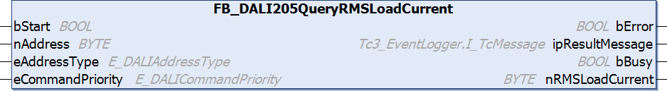

The function block reads the root mean square of the load current from the DALI control gear (rmsLoadCurrent).
bError is set to TRUE if the DALI control gear returns the value 255 (MASK). In this case, the value cannot be determined by the DALI control gear.
FB_DALI205QueryRMSLoadCurrent 2:
Prior to the DALI command QUERY RMS LOAD CURRENT, the function block sends the DALI command ENABLE DEVICE TYPE 4, as is necessary for application extended commands (see also FB_DALI102EnableDeviceType).
The output nRMSLoadCurrent only contains a valid value if the function block was executed without errors (bError = FALSE).
FB_DALI205QueryRMSLoadCurrent 3: Inputs
  bStart            : BOOL;
  nAddress          : BYTE;
Type
bStart
nAddress
BYTE
eAddressType
E_DALIAddressType
eCommandPriority
E_DALICommandPriority
FB_DALI205QueryRMSLoadCurrent 4:
FB_DALI205QueryRMSLoadCurrent 5: Outputs
  nRMSLoadCurrent         : BYTE;
Type
ipResultMessage
I_TcMessage
bBusy
nRMSLoadCurrent
BYTE
Returns the root mean square of the load current (see rmsLoadCurrent).
