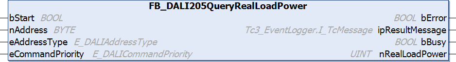

FB_DALI205QueryRealLoadPower
FB_DALI205QueryRealLoadPower 1:
The function block reads the current active power of the load from the DALI control gear (see realLoadPower).
bError is set to TRUE if the DALI control gear returns the value 65535 (MASK). In this case, the value cannot be determined by the DALI control gear.
FB_DALI205QueryRealLoadPower 2:
Prior to the DALI command QUERY REAL LOAD POWER, the function block sends the DALI command ENABLE DEVICE TYPE 4, as is necessary for application extended commands (see also FB_DALI102EnableDeviceType).
The output nRealLoadPower only contains a valid value if the function block was executed without errors (bError = FALSE).
FB_DALI205QueryRealLoadPower 3: Inputs
  bStart            : BOOL;
  nAddress          : BYTE;
Type
bStart
nAddress
BYTE
eAddressType
E_DALIAddressType
eCommandPriority
E_DALICommandPriority
FB_DALI205QueryRealLoadPower 4:
FB_DALI205QueryRealLoadPower 5: Outputs
  nRealLoadPower          : UINT;
Type
ipResultMessage
I_TcMessage
bBusy
nRealLoadPower
UINT
Returns the current active power of the load (see realLoadPower).
FB_DALI205QueryRealLoadPower 6: Properties
Type
Access
Initial value
ipDALICommunication
I_DALICommunication
Get, Set
NULL
Requirements
Development environment
Required PLC library
TwinCAT from v3.1.4024.35
Tc3_DALI from v3.13.0.0
