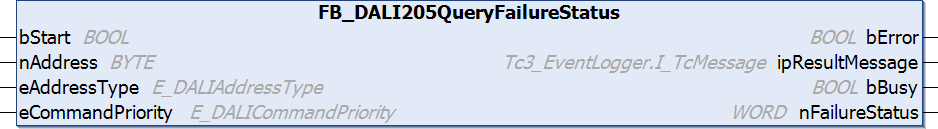

FB_DALI205QueryFailureStatus
FB_DALI205QueryFailureStatus 1:
The function block reads the failure status from the DALI control gear (see failureStatus).
FB_DALI205QueryFailureStatus 2:
Prior to the DALI command QUERY FAILURE STATUS, the function block sends the DALI command ENABLE DEVICE TYPE 4, as is necessary for application extended commands (see also FB_DALI102EnableDeviceType).
The output nFailureStatus only contains a valid value if the function block was executed without errors (bError = FALSE).
FB_DALI205QueryFailureStatus 3: Inputs
  bStart            : BOOL;
  nAddress          : BYTE;
Type
bStart
nAddress
BYTE
eAddressType
E_DALIAddressType
eCommandPriority
E_DALICommandPriority
FB_DALI205QueryFailureStatus 4:
FB_DALI205QueryFailureStatus 5: Outputs
  nFailureStatus          : WORD;
Type
ipResultMessage
I_TcMessage
bBusy
nFailureStatus
WORD
Returns the failure status (see failureStatus).
FB_DALI205QueryFailureStatus 6: Properties
Type
Access
Initial value
ipDALICommunication
I_DALICommunication
Get, Set
NULL
Requirements
Development environment
Required PLC library
TwinCAT from v3.1.4024.35
Tc3_DALI from v3.13.0.0
