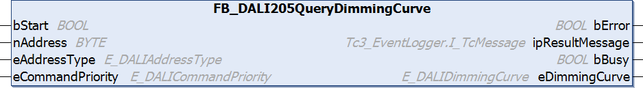

The function block reads the set dimming curve from the DALI control gear (see dimmingCurve).
FB_DALI205QueryDimmingCurve 2:
Prior to the DALI command QUERY DIMMING CURVE, the function block sends the DALI command ENABLE DEVICE TYPE 4, as is necessary for application extended commands (see also FB_DALI102EnableDeviceType).
The output eDimmingCurve contains a valid value only if the function block was executed without errors (bError = FALSE).
FB_DALI205QueryDimmingCurve 3: Inputs
  bStart            : BOOL;
  nAddress          : BYTE;
Type
bStart
nAddress
BYTE
eAddressType
E_DALIAddressType
eCommandPriority
E_DALICommandPriority
FB_DALI205QueryDimmingCurve 4:
FB_DALI205QueryDimmingCurve 5: Outputs
  eDimmingCurve           : E_DALI_DimmingCurve;
Type
ipResultMessage
I_TcMessage
bBusy
eDimmingCurve
BYTE
Returns the currently set dimming curve (see E_DALIDimmingCurve).
