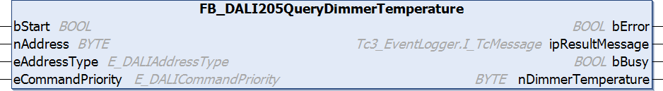

FB_DALI205QueryDimmerTemperature 3: Inputs
  bStart            : BOOL;
  nAddress          : BYTE;
Type
bStart
nAddress
BYTE
eAddressType
E_DALIAddressType
eCommandPriority
E_DALICommandPriority
FB_DALI205QueryDimmerTemperature 4:
FB_DALI205QueryDimmerTemperature 5: Outputs
  nDimmerTemperature      : BYTE;
Type
ipResultMessage
I_TcMessage
bBusy
nDimmerTemperature
BYTE
Returns the current operating temperature (see dimmerTemperature).
