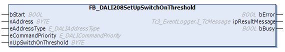

FB_DALI208SetUpSwitchOnThreshold 1:
The function block stores the value nUpSwitchOnThreshold in the variable upSwitchOnThreshold of the DALI control gear.
The output from the DALI control gear is set as soon as the rising virtual output value reaches or exceeds the threshold value upSwitchOnThreshold.
With the value nUpSwitchOnThreshold = 255 (MASK) the threshold is disabled.
The DALI command is only supported by the DALI control gear if bit 3 of features is set.

FB_DALI208SetUpSwitchOnThreshold 5: Inputs
  bStart                  : BOOL;
  nAddress                : BYTE;
  eAddressType            : E_DALIAddressType := E_DALIAddressType.Short;
  eCommandPriority        : E_DALICommandPriority := E_DALICommandPriority.MiddleLow;
  nUpSwitchOnThreshold    : BYTE := 255;

FB_DALI208SetUpSwitchOnThreshold 6:
Type
BYTE
Threshold value (0…255) for switching on the output with a rising virtual output value.
