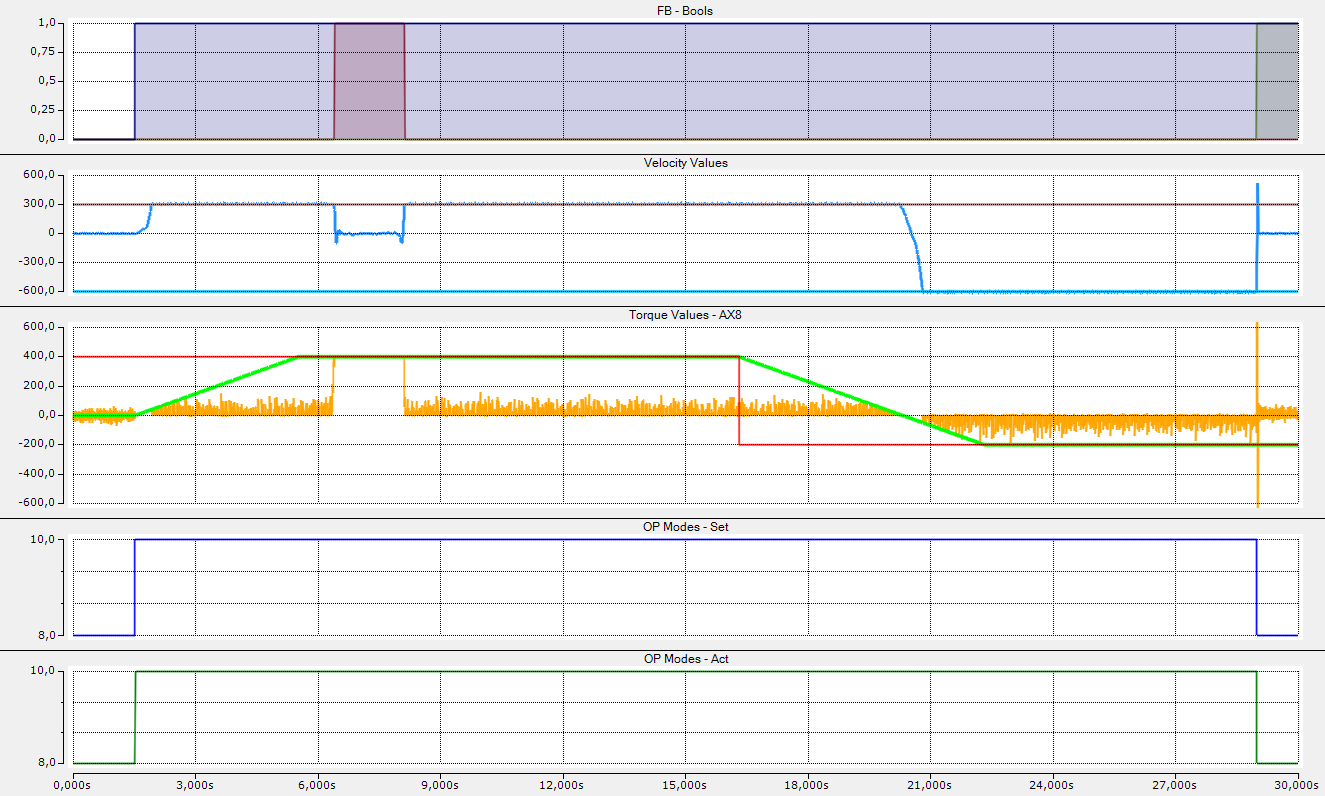

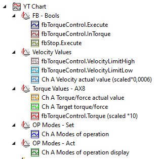

Beispiel MC_TorqueControl beim AX8xxx
    Axis_Main              : AXIS_REF;
    bExecute_TorqueControl : BOOL;
    fTorque                : LREAL;
fTorque := 35;
fbTorqueControl(
    Axis               := Axis_Main,
    Execute            := bExecute_TorqueControl,
    ContinuousUpdate   := TRUE,
    Relative           := FALSE,
    Torque             := fTorque,
    TorqueRamp         :=   10,
    VelocityLimitHigh  :=  400,
    VelocityLimitLow   := -500,
    BufferMode         := ,
    Options            := ,
    InTorque           => ,
    Busy               => ,
    Active             => ,
    CommandAborted     => ,
    Error              => ,
    ErrorId            => );
MC_TorqueControl 8:
MC_TorqueControl 9:
