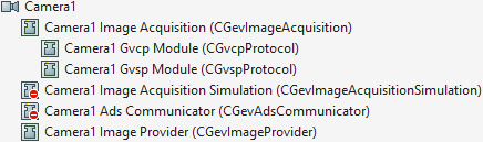

Each GigE Vision camera instance contains a number of TcCOM objects in the TwinCAT project:

GigE Vision Image Acquisition
The GevImageAcquisition object coordinates the communication with a GigE Vision camera. It consolidates and manages two sub-objects that implement the two protocols of the GigE Vision standard:
Diagnostic information on the camera communication can be found on the Parameter (Online) tab of the two sub-objects.
It also uses a UDP/IP stack on an appropriate network adapter to communicate with a GigE Vision camera. Diagnostic information can also be retrieved in these objects. Details on both diagnostic options can be found in the Appendix/Troubleshooting at Camera communication.
The RT-Ethernet adapters and IP stacks can be found in the TwinCAT project under the I/O node:
TcCOM objects 4:
Image acquisition and the two protocols (GVCP and GVSP) are parameterized in the Configuration Assistant in the configuration tree. A description of the parameters can be found in Chapter TcCOM parameters. This object is deactivated when camera simulation is active.
GigE Vision Image Acquisition simulation
The GevImageAcquisitionSimulation object simulates the streaming behavior of a GigE Vision camera and is deactivated by default. If the simulation mode is active, the GevImageAcquisition object is deactivated instead.

GigE Vision Ads Communicator
The GevAdsCommunicator object is required when recording a camera stream. It sends corresponding images from the router memory to the TwinCAT Vision service via ADS. In contrast to saving images via the function block FB_VN_WriteImage, a separate TcCOM object is required for the record functionality, since the recording runs independently of the PLC processing.

GigE Vision Image Provider
The GevImageProvider object represents the interface between a camera and corresponding function blocks in the PLC. These include FB_VN_GevCameraControl, FB_VN_SimpleCameraControl, FB_VN_ReadRegister and FB_VN_WriteRegister, and FB_VN_ReadMemory and FB_VN_WriteMemory. To this end, the object in the Symbol Initialization tab of the project instance must be linked with the desired PLC symbols of the function blocks. If several camera instances exist in the project, ensure that the correct GevImageProvider module is selected based on the name.
