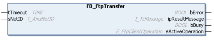

FB_FtpTransfer
This function block can be used to initiate and manage upload and download operations.
Inputs
tTimeout : TIME;
sNetID : T_AmsNetID;
tTimeout | TIME | Indicates the ADS timeout to be used between PLC runtime and the FTP client user mode process (in seconds). |
sNetID | T_AmsNetID | AmsNetID of the device on which the FTP client user mode process is running. Normally, the FTP client and the PLC run on the same system, so no value needs to be assigned to this variable. |
Outputs
bError : BOOL;
bBusy : BOOL;
eActiveOperation : E_FtpClientOperation;
bError | BOOL | TRUE if an error has occurred. |
ipResultMessage | I_TcMessage | Output with extended error and diagnostic information based on the TwinCAT 3 EventLogger. |
bBusy | BOOL | TRUE as soon as the function block is in use. |
eActiveOperation | Indicates the current transfer operation. |
