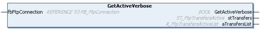

GetActiveVerbose
Provides detailed information about transfer operations currently in progress.
Syntax
METHOD GetActiveVerbose : BOOL
fbFtpConnection : REFERENCE TO FB_FtpConnection;
stTransfers : ST_FtpTransfersActive;
aTransfersList : A_FtpTransfersActiveList;
Return value
Name | Type | Description |
GetActiveVerbose | BOOL | Returns TRUE if the currently active transfer operations have been successfully returned. |
stTransfers | Contains the number of transfer operations currently in progress. | |
aTransfersList | Contains a list of TransferHandles of all currently running transfer operations. |
Inputs
fbFtpConnection | References the server connection to be used for the operation. |
