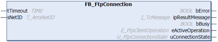

FB_FtpConnection
This function block can be used to manage a connection to an FTP/SFTP server. Different methods allow you to create a profile, connect to the server, and disconnect from the server.
Inputs
tTimeout : TIME;
sNetID : T_AmsNetID;
tTimeout | TIME | Indicates the ADS timeout to be used between PLC runtime and the FTP client user mode process (in seconds). |
sNetID | T_AmsNetID | AmsNetID of the device on which the FTP client user mode process is running. Normally, the FTP client and the PLC run on the same system, so no value needs to be assigned to this variable. |
Outputs
bError : BOOL;
bBusy : BOOL;
eActiveOperation : E_FtpClientOperation;
uConnectionState : U_FtpConnectionState;
bError | BOOL | TRUE if an error has occurred. |
ipResultMessage | I_TcMessage | Output with extended error and diagnostic information based on the TwinCAT 3 EventLogger. |
bBusy | BOOL | TRUE as soon as the function block is in use. |
eActiveOperation | Indicates the current operation. | |
uConnectionState | U_FtpConnectionState | Indicates the current connection state. Will be updated automatically. |
