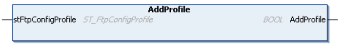

Adds a new connection profile.
Syntax
METHOD AddProfile : BOOL
    stFtpConfigProfile : ST_FtpConfigProfile;
AddProfile 2: Return value
Type
AddProfile
Returns TRUE when the method has completed. Whether the action was successful can be read from the bError variable of the function block.
AddProfile 3: Inputs
Type
stFtpConfigProfile
ST_FtpConfigProfile
Structure with further information on the profile to be created.
