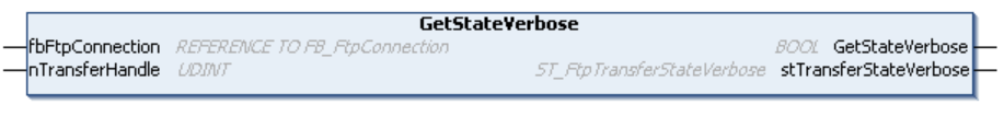

Returns detailed information on a specific transfer operation. This method can be used, for example, to check the progress of a file upload/download.
Syntax
METHOD GetStateVerbose : BOOL
    fbFtpConnection : REFERENCE TO FB_FtpConnection;
    nTransferHandle : UDINT;
    stTransferStateVerbose : ST_FtpTransferStateVerbose;
GetStateVerbose 2: Return value
Type
GetStateVerbose
Returns TRUE when the method has completed. Whether the action was successful can be read from the bError variable of the function block.
Contains detailed information on the transfer operation.
GetStateVerbose 3: Inputs
Type
fbFtpConnection
FB_FtpConnection
References the server connection to be used for the operation.
nTransferHandle
UDINT
TransferHandle of the transfer operation.
